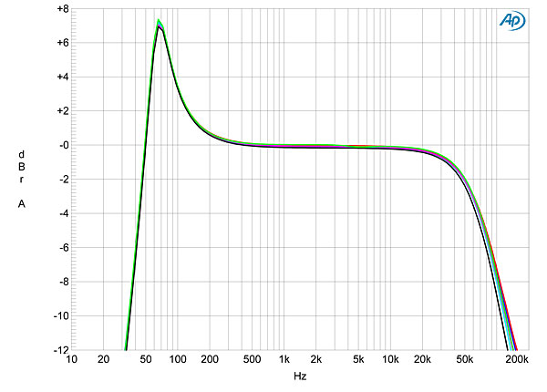

So, how do I match level of
2 integrated amplifiers with responses at "flat" setting like this? At 1 kHz? Really?

Of course. In case that amplifiers have frequency response dependent on complex load, which may be in 0.1 dB to 1 dB order, thus audible, you have to record outputs electrically and examine it by Deltawave or Adobe Audition. Based on such analysis you make matching according to average rms or similar criterion. It is much more precise than single tone 1kHz matching. Try it. This forum is called Audio Science, not Laymen.
Ideally, when there are stronger differences than 0.1dB/20deg then simple level matching is impossible and A/B comparison will very likely be dominated by those differences.
That is, you can A/B those different frequency responses directly, without any DUT or with the same DUT eq'd and will get detectable differences from that alone.
That means, to compare two different DUTs, their frequency responses must be minutely matched first to remove this variable. And the variable itself can be checked independently.
