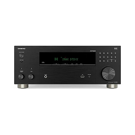

Can you tell me if the knobs on the front, specifically the master volume control, is made of metal or plastic?
Almost certainly plastic, but I'll check as soon as I wander downstairs.
Thanks; that's disappointing at this AVR's price level, to say nothing of the fact that it's part of the premium RZ range.
Sorry, I got distracted by a squirrel....
Everything is definitely plastic. It's reasonably high quality plastic, and I think it looks fine overall, though I've never loved the Onkyo AVR aesthetic. I get wanting something a little more premium looking/feeling, but this seems like the standard anymore at this price point, especially given this price includes the Dirac license. I wouldn't pay full price for it, mind you, but it seems to be regularly available for $750 or so. At full price, I'd probably reach just a bit higher for the Denon X3800h
