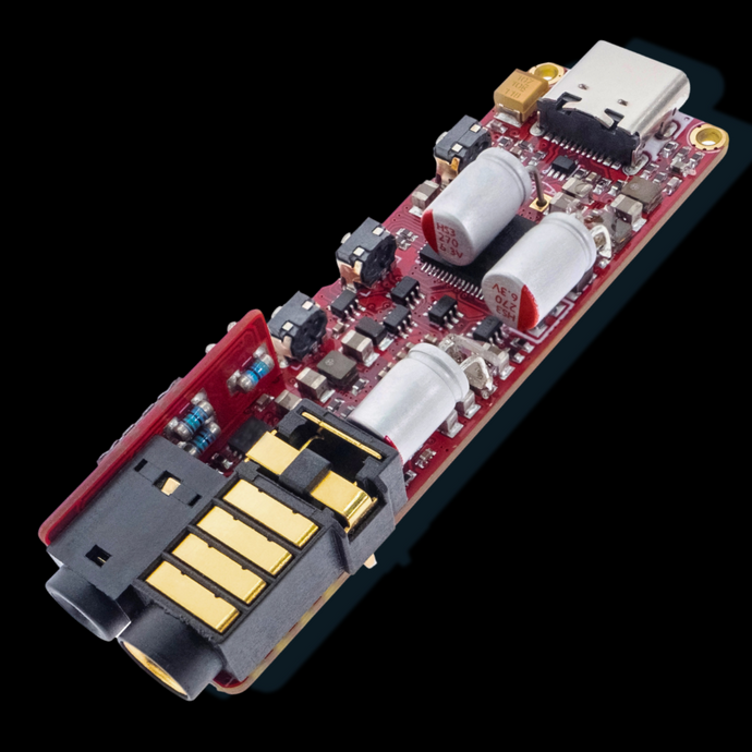

$469... iFi Go Kensei dongle on "Cirrus Logic DAC". However, 7.2Vrms at 600Ohm without battery!
Asking $450 for a dongle with a Cirrus chip? And not even PEQ but a bunch of marketing gimmicks? Come on.
Even FiiO KA15 can do more for $99. Its low-impedance driving capability is greater than this iFi dongle. The SGM8262 op-amp in KA15 is a monster.
7.2 Vrms at 600 Ohm on bus power is simply from boosted rails and high output gain. Unless analog gain is attenuated, its noise floor must be quite high. Sure, DRE helps :) It touts low noise (from DRE?), but until it is actually measured, we never know.
Its power will be quickly current-limited as load gets heavier, anyway. The sensitivity of high-impedance dynamic headphones is not horrible in most cases. What is demanding is the load of some planar headphones.
As for iFi products, I truly wonder how iFi as a brand is still surviving. The brand is not recognized as a reputable company here at ASR. Obviously ASR people represent a much smaller group than people browsing HeadFi.
@CedarX Have you seen my PM? (will edit this part later).
I think this is due to the combined effect of multiple factors in consumer psychology. The key to the success of an audiophile product lies in how to make consumers "feel" good about it. Whether it is actually good (in terms of measurable performance) is another thing.
Visual impact plays a significant role. Audiophiles will buy those high-priced cables that clearly show no difference in tests, simply because they look like they can make the sound better.
Look at this, big capacitor! power!:D
