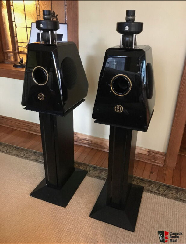

Somewhere around 2000 I listened to the MBL 101D speakers at the home of a reviewer for the absolute sound. They were in a very small heavily treated room with close seating. Especially with the lights down it was simply the most realistic sound I’ve ever heard. If the imaging had been as vague as you seem to suggest, there’s no way it would’ve sounded realistic to me, since image palpability is quite important to me.
And that experience carries over to my having owned my MBL 121 stand mount speakers .
The problem when it comes to talking about imaging is that it’s such a subjective mental phenomenon it’s hard to get truly precise.
It’s not like we can map out in the air in front of us to how big an image is within the inch or something. So if you’re thinking in precise and I’m thinking precise, it’s hard to know for sure if our mental model is matching exactly.
I can tell you this though: what I look for in imaging is precision and Sonic density, so that a sonic images seems to be in a precise place, and a solid object moving air, not something phasey and see-through.
But I also don’t like imaging that is “ too” focussed and tight. I find a lot of systems, especially those that employ lots of toe-in to the speakers, can focus Sonic images down so tight they become artificially squeezed smaller than life, and with the sense of a harder edge than I hear in life.
So I typically have my speakers never towed directly in and often, if not facing forward, then towed in just a bit to the listening position. I’m trying to keep enough focus and precision and density, but I also want to slightly expand and soften the very edges so it sounds to me more relaxed, and natural and less mechanical.
So I don’t know if somewhere in there is to be found our difference of opinion.
Still, I kind of doubt it because again I value image precision intensity so much, and I own Thiel speakers that are known for their precision in imaging.
And then there’s my room in which I listened to the MBLs, which as I mentioned before, was redesigned with the help of an acoustician, so there’s acoustic treatment hidden in parts of the room, such as the ceiling bulkhead, the wall behind the speakers, etc. Plus, I have two different sets of two different type of curtains running on tracks around the entire room. I can therefore pull for instance, thick velvet curtains to any point in the wall or even literally cover every inch of the walls in the room. So I can go for a live sound or a dead sound or anything in between.

You need to visualise what happens to the reflected sound that is coming off any of those speakers that are Omnis - if the resulting reflection is within around 1 to 10ms of the direct sound, it will affect localisation (ie: degrade it) - if the reflection arrives more than 10ms after the direct sound, it adds to the sense of space / ambiance (our own minds automatic filter cuts in!)
So wherever a speaker is close enough to the wall, for the reflected soundwave to arrive within that time... it becomes a problem (unless absorbed or dispersed... "treated")
You need it to travel approximately 1.7m or so (2m is usually pretty safe) to the reflecting surface (so the total path from speaker to reflective surface and back to speaker should be more than 3.5m... ie: 10ms)
That means that without treatment, the room needs to be substantially bigger to allow that space.
Alternatives include angled panels/walls to ensure that the soundwave is reflected at an angle away from the listening seat, by the time it hits another surface and bounces back into the listening area, the path will then have increased to beyond the critical 10ms.
Think of all hard surfaces as sonic mirrors....
Bookshelves full of books, will absorb some frequencies, and reflect a lot in various directions due to the books ... often an excellent (and WAF friendly!) treatment.... the eggcarton style waffle treatment, break the sound up and reflect it in various directions - so not much is left to reflect back directly to the listening area.... Curtains can work very well at the key midrange and higher frequencies, but tend to be transparent in the bass...
A multi channel system, vs a stereo omni system, are not really comparable - the multi channel setup will attempt to emulate ambiance and space via various algorhythms.... software - and results will vary depending on the software.
Omni's will achieve a sense of space/ambiance, mechanically / acoustically (so to speak) - in a fixed manner, but one that is "natural" - and often sounds that way to our ears.
Software solutions - surround - range from good, to horrible.... Omni's due to the naturalness of the way they broadcast sound, tend to start off from a higher base than artificial setups.
