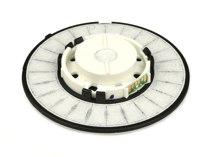

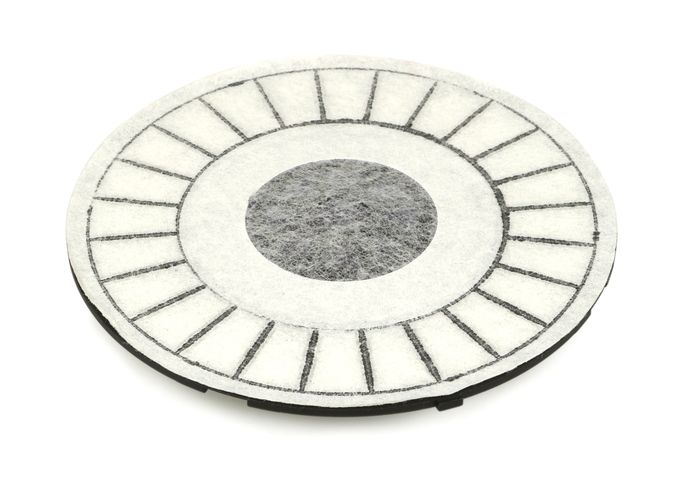

I wonder how some people went through life without taking off the pads of their headphones to discover paper surrounding the drivers.
Here's a replacement Beyerdynamic DT770 driver unit with paper on both sides of the driver:
I wonder how some people could go through this whole thread and conclude that some passive (thus digital EQ not available as a design element) headphones having been designed with specifically constructed and tested acoustic dampeners in them means toilet paper is a better tool to fix a headphone's flaws than digital EQ for the consumer.
