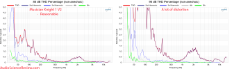

Amir posts speaker "SINAD" in every review:
Musician Audio Knight I V2 Speaker Backpanel relative THD distortion Measurements.png
You can convert Percent to dB here: https://sengpielaudio.com/calculator-thd.htm
And SINAD is just the resulting dB number times -1.

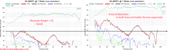

Or you can look at the absolute SPL data:
Musician Audio Knight I V2 Speaker Backpanel THD distortion Measurements.png
The distance in dB between Fundamental and THD at any given frequency is "SINAD".
