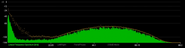

Why would you want a file that was filled with more ultrasonic noise than actual musical content, Paul?
The "It's ultrasonic so we can't hear it" thing doesn't fly when most "audiophiles" typically insist that they can hear the ultrasonics, and if they can't hear them they can "feel them."
When you look at the spectrum of DSD, particularly of this awful release, you see that the ultrasonic noise extends down to the frequency range of where CD bandwidth ends. So you're better off just listening to the CD.
Look at that noise floor. It's laughable.
