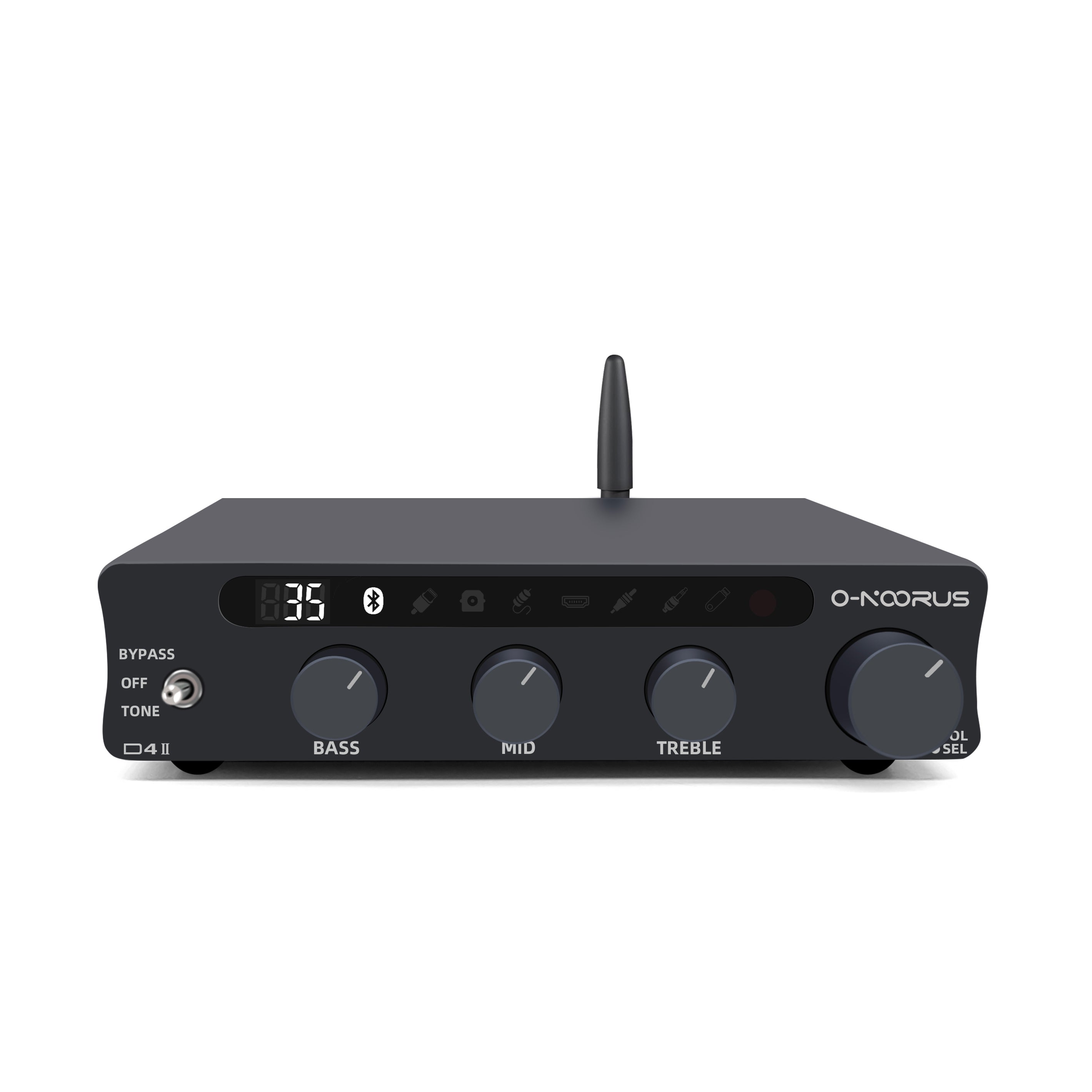

@Alexander Lin can you please specify what modifications are done in D4 ii to get SINAD of 90. So that I can modify my D4 (old).
Thanks
The power supply filtering has been improved, and the audio path has been fully balanced.
Well done Alexander ;)
Latest D4II
