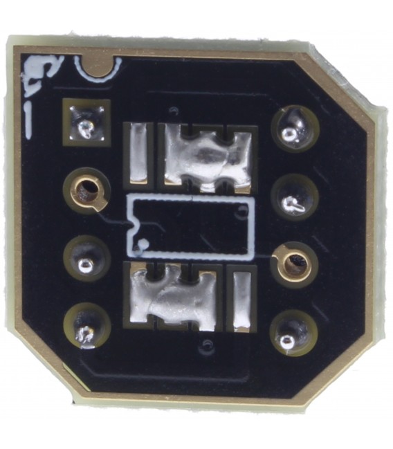

Question : is that possible to bypass the op amps with these OPA ghost ? If yes : any incidence related to the buffer ? I guess we need a good output voltage from the DAC ?

I don't recommend using this 'GHOST OPA' because it depends directly on the assembly in which it will be set up and it requires 'quite sharp' knowledge because the OPAMP is not always only used for gain in a circuit.
In addition, 'novices' people will install it 'everywhere' where possible, which can represent a risk of significant malfunction of the device concerned or worse of breaking it down :(
I think it's a mistake to sell this type of device: who will take responsibility for it in the event of a problem ?
I don't understand what it means. Is it a short-circuited OP-AMP buffer?
