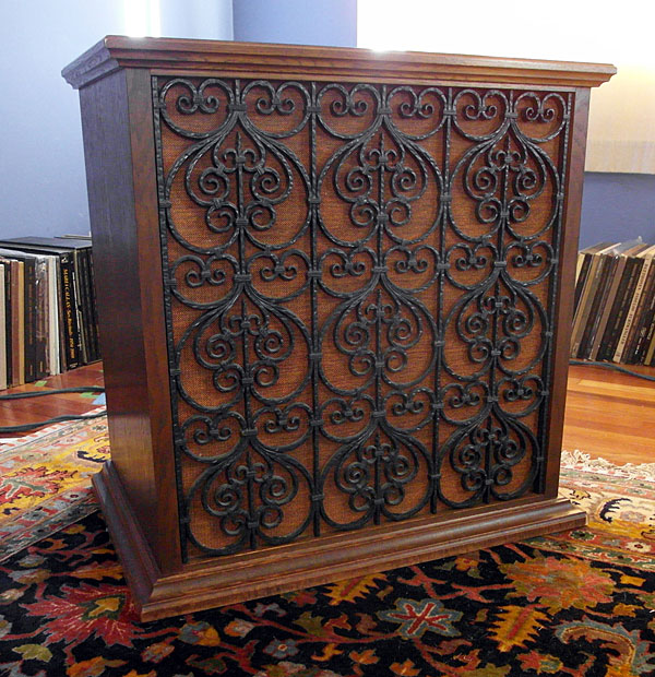

I'll take this opportunity to note that, while the Valencia was touted in its day by Altec as a housebroken domesticated version of (the A7 morph of) the Voice of the Theatre, the small (it's all relative!) bass reflex enclosure was far from the front horn loaded, very large vented enclosure alignment of a "real" A7. :)
The biggest impact of this: decidedly rolled-off LF response. Mind you, I owned a pair of 846A Valencias (the original 16 ohm morph, with 416A woofer and 806A compression treble driver) and loved the sound overall -- but they do leave something to be desired at the low end.
Oh. Ahem. The other thing I wanted to mention ;) -- Altec did indeed make a proper domestic version of the A7: the modestly-monikered Altec Magnificent. :)
They had the same design asthetic of the aforementioned Valencia, but in a much bigger package. :)
