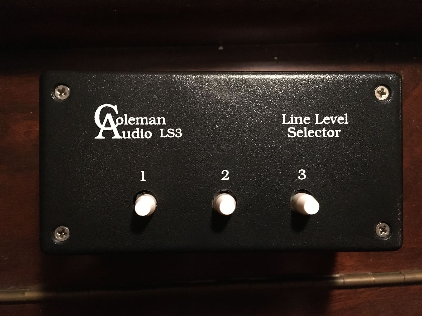

A/B listening tests is part of my hobby. I'm glad I've found the switcher that doesn't have crosstalk issues. Its price is the only drawback.
Since the Coleman MS6A does't seem to have any wired remote capability (unlike the 7.1SW), how do you perform your A/B tests? Do you need to sit right in front of your rack so that you can switch between the sources? Assuming your rack lies in between your speakers, you may be sitting too close to your speakers preventing you from drawing any relevant conclusions from your A/B tests.
For $850 you could get the combo Topping Pre90+Ext90. You can switch between 4 sources (3 balanced + 1 unbalanced) with a remote control. And when you don't do your A/B tests, you still have one of the best measuring preamps on the market.
The rack sits on my desk within easy reach. I listen to headphones most of the time, so I don't need the RC for the switcher.
Fair point, I didn't realise you were performing your A/B test mainly with headphones.
