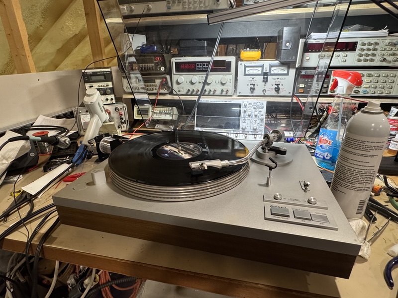

Just got this repaired, and testing on the bench, a Yamaha YP-D6 auto-return turntable from my friend in Texas. This will be going to my niece, who is a musician in Ohio who has LPs that she would like to be able to play.
The auto-return mechanism was gummy and needed a thorough cleaning, plus everything needed to be set up properly again. And, of course, the nylon spindle gear was cracked, but I superglued it together and they seem to work happily even when not repaired. The speed adjustment pots needed a DeOxit bath, too.
CEC made this turntable, and it's actually not bad. It's direct-drive with a very heavy platter, and the auto-return system is utterly disengaged during actual play. The tonearm has a little play in the vertical shaft but the horizontal shaft is tight. Damping on the cueing lift is a bit grabby, but I don't have any damping oil and it will serve. Cartridge is a Signet--AT's fancy-rug line in the day. The vintage is 1977, the same year I bought my Technics SL20.
My niece's AVR does not have a phono input, so I've bought (on ebay) an Audio-Technica AT-PEQ3 phono stage.
Nothing clutters a bench like working on a turntable--mix of mechanical and electrical activities means pulling out every tool known to man.

Screw the turntable, I want that workshop.

A million times this. All my projects are either done outdoors -- which is fine until we get a hurricane -- or on the dining table, which means they are time limited by family member appetites.
We built the shop in 2021, as a Covid project. I cashed in about two-thirds of a retirement package from an old employer to pay for the construction. The pitch of the roof was steep enough for the room upstairs. The Redhead painted the T&G subfloor panels and I drywalled just the bottom 4 feet to keep from dropping things.

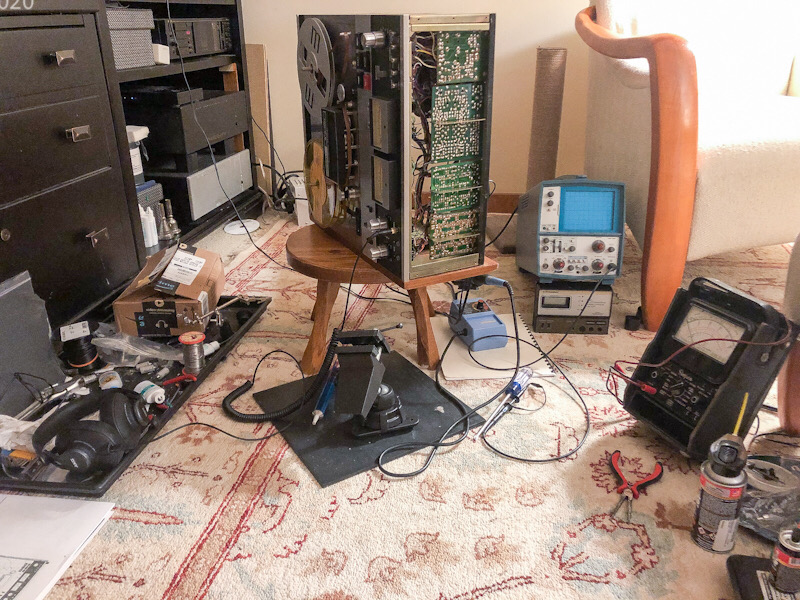

Building out the electronics bench has been more recent. I've had a limited selection of test equipment for a while--the Tektronix scope in the middle, the Trio SSVM at upper left, the Tektronix budget-line function generator and frequency counter, the Power Designs bench power supply, a B&K capacitor tester, a Simpson 260, band the Fluke handheld DMM. You can see some of that in the thread I posted about repairing my old Teac 4300 open-reel tape deck. As you can see, the workbench was the floor of the living room, which did not receive unwavering approval from the Redhead.
Working on stuff is more fun now :)
