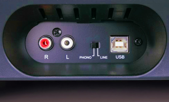

My new DJ-Tech turntable sounds better every day. Of course, not by itself, but as a result of targeted interventions. For example, with the integrated phono preamplifier along with USB interface, the question arose: Bypass or total surgery. I decided for an amputation and removed this module mercilessly.
It had turned out that it is not enough to set the switch on the device to 'phono', because the connection remains loaded with a capacitor filter. Now I connected my RCA cable to the amplifier directly to the thin wires coming out of the tone arm and - lo and behold - a dark veil is drawn away from the music stage.
