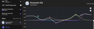

I understand wanting to replace roon , the cost keeps increasing but most likely the sound quality difference you're experiencing is losing your EQ in roon that's where you need to focus is finding a way to keep that ability in your chain if you cancel it.
This is exactly what I referred to in the previous posts, if I get the same quality by replacing Parametric-EQ in ROON with EQ in RME ADI-2DAC.
I would think so but I would measure the room again. The Minidsp SHD which is cheaper than the RME and has Dirac if you're inclined to try could be something to consider to try. Replace the Node as well since it's a streamer.
