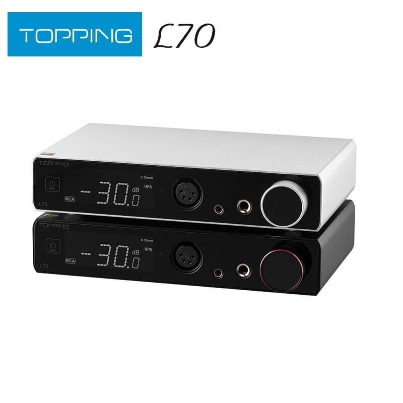

Topping just released their top of the line headphone amp of the L family and the specs are insanely good: fully balanced, a tad more power than the A90 in all impedances except 16ohms, relay knob.
They even got rid of the massive power brick that plagued the L30 and 50. And all that for 350 bucks. Thats just crazy, not only decimates the competition, but also the A90 and A30pro.
Looks like a winner on paper. Let's see how it behaves on the bench. Looking forward to see it reviewed by @amirm any time soon. However, I have no intentions to replace my A90D with the L70 ;)
