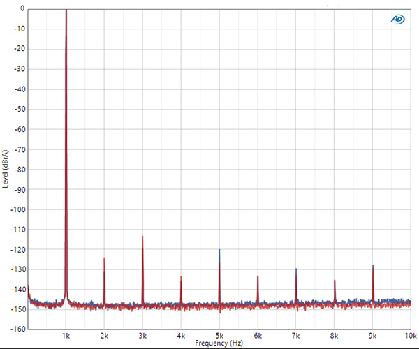

It is not appropriate to take just one measurement, the harmonic distortion spectrum, to contradict my conclusion that the Weiss DAC204's "The measured performance of the Weiss 204 is state of the digital art." If you look at the complete set of measurements at the link below, you will note that as well as both harmonic and intermodulation distortion still being extremely low in level, the DAC204 offers vanishingly low linearity error down to –120dBFS with 24-bit data, an extremely low noisefloor with a measured resolution of 21 bits, and complete rejection of data-related jitter. Taken together, this led to my conclusion.
John Atkinson
Technical Editor, Stereophile
I respectfully disagree and stand by what I wrote. Excelling in 3 out of 4 metrics but having "average" harmonic distortion by today's standards is not state of the art. Specially when alternatives excel in all of them for a fraction of the price.

Can you please state the sample rate at which the published harmonic distortion FFT has been taken ?

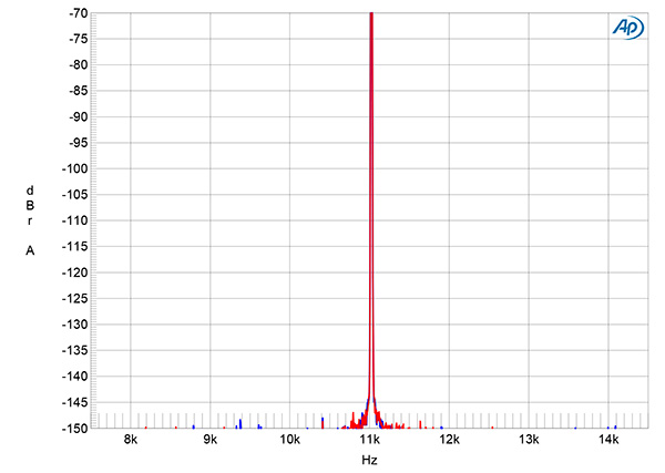

We are used to much better performance around here. :) I am puzzled by the jitter test:
If this is J-test, why is the spectrum of the square wave missing? Here is a comparison to a $300 DAC (with 48 kHz sampling):
index.php
You can see the square wave being resolved on the left. But I don't see that in your measurement. Ignoring that bit, pun intended, the rest of the response is just as clean as the Weiss (note that I go down to -160 dB vs your -150 dB).

I hope you see that compared to what we are used to, the Weiss DAC is not state of the art.
No question that compared to much of what goes on in high-end audio, the Weiss is class leading but compared to what we see, it is yesterday's news at high prices.
