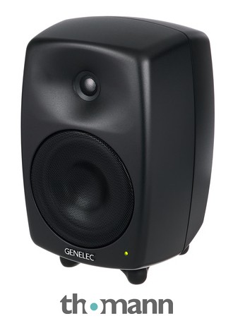

Personally I really like the Genelec 8030. Using these or the bigger 8040 or 8050 with subs and an avr to take care of the equalisation part, is the path I've personally chosen. They can be wall mounted too and are available in black, white or grey. The G3, G4 and G5 are the same but have both xlr and rca inputs.

I had genelec 8040, they were ok but prob one of the worst measuring genelecs there are. 3khz xo point is just way too high for that 6.5” to have good directivity.
I’m surprised to hear that. And a bit disappointed too. I had assumed that all Genelecs were up to snuff.
Teach me to assume without research.
8040 with 6.5' woofer and 3khz crossover vs 8050 with 8' woofer and 1.8khz crossover from the manual:
