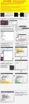

Has anyone (probably with a working knowledge of the Chinese language) installed the firmware update successfully? I run the supplied software (having set it to the appropriate COM port) and, following step 7, nothing further happens… well at least it doesn't brick the unit!
Any further thoughts please?
Has anyone (probably with a working knowledge of the Chinese language) installed the firmware update successfully?...
No Chinese. I installed it successfully, as have others, using the PDF upgrade tutorial that is part of the download, which is correct and has notes in English. Nothing happened for me until I was sure I had just the single correct USB C cable (that is supplied with the DAC) connected to the upper port, not the lower port that it is normally used with. I discovered that when the connection was correct on my Windows 11 computer, the correct USB Com Port would show up in the Device Manager when the DAC is powered on, and disappear when it is powered off. See my post #158 on this thread.
It is just a few steps. Connect the DAC with the original cable to the top port (check it with the device manager). Power off the DAC, start the software, power on the DAC, select the middle button so you can choose the com port, then select the left button to install the software.
I think I have that right, but the upgrade tutorial was correct. The instructions say if your DAC is very recently purchased, it has already been updated and nothing will happen.
the PDF instructions that are part of the download
I see no PDF, only a couple of JPGs -- is this what you are referring to?
Anyway, nothing so far. Using the upper port and supplied cable; CH340 (COM3) shows up as expected although, if you follow the instructions, the unit should remain switched off. In my case the above device manager entry remains visible whether the unit is powered-up or not. Setting the supplied software to operate on COM3 seems fine but nothing further happens when step 7 is executed (I take it you had a response that was, more or less, instant)
Hence an explanation of the meaning of some of the Chinese might be useful.
I was doing this from memory. I can try again or we can wait for a Chinese linguist. The instructions in the JPG are correct.
1. you are right, the Comport shows when the DAC is 1st plugged into the PC and shows until it is unplugged, so you are probably getting a solid connection and are using the correct com port.
2. A previous poster here indicated that they had to change the data rate property of the com port settings to 4800 from the default 9600 Windows setting for it to work. I did not do that but you could try it.
3. Step 8 in the JPG shows pointing the remote at the DAC and hitting the input button. This turns the DAC on and to the USB input (the display lights), that is how the Software finds the MCU. The update starts after you do that. I had forgotten that step. My failing memory, not Chinese. I hope this helps.
Right, the crucial step to get it working (for me) appears to have been that step 8 should actually be carried out immediately following step 7*, at which point the display lights up and the operation completes within a few seconds.
* rather than waiting [ad infinitum] for "Detecting the target MCU" which will never happen while that part of the unit is effectively switched off!
it takes only 2sec , probably, or less
