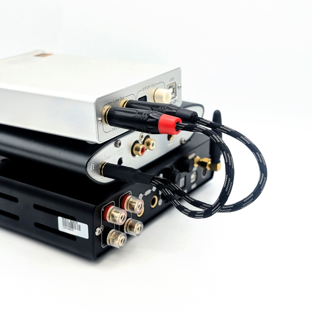

@MC_RME nice unit! That lockable USB-C is a monster! :) Do you have any plan to offer (e.g. by ALVA) a dual TRS to Pentaconn adapter?

Thanks @enricoclaudio Very well made cables! Actually in this case we need a Pentaconn female adapter to plug in the HD-650 balanced cable. I see that stuff on Aliexpress only.

Yes, this way USB-C is indeed monster-stable and reliable. Regarding the adapter - I am sure I answered that before. AliExpress, look for 'OPENHEART Balanced Headphone Adapter Cable for RME TEAC Dual 6.35mm to 4.4mm Female to Dual 6.35mm Dual 1/4 to 4.4 Female Cable'. Around 20 bucks.
