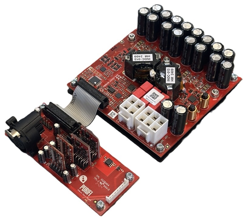

and now comes the new input board for 9040 with discrete opamps and regulators made by Bruno himself:
Purifi have listed an evaluation kit for the 1ET9040BA for some time, using the FE04 front end board.
So if like me you're wondering what's new - they've added a second "Deluxe" evaluation kit using an improved FE05 front end board.
The differences are:
Discrete Ultra Low Noise and distortion Pre-gain stage w/ selectable gain and bypass option (jumpers)
Discrete low noise high PSRR Voltage regulators for OPAMPs
139 EUROs more
Previous front end boards or buffers have compromised Hypex and Purifi amp performance, so hopefully this board will perform better.
