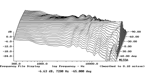

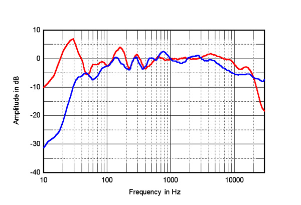

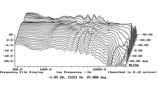

My experience is very different there, a LP sound power peak above 2 kHz can often sound harsh, ideally the response should be be dropping or at last be flat which also JA noticed and as always stated very diplomatically:
While the Dovedale's mid-treble could sound a little too forward with some recordings
the Dovedales have a little too much mid-treble energy
However, both the demanding impedance and the slight excess of presence-energy in the in-room balance will make amplifier choice critical in getting the best from this speaker.
