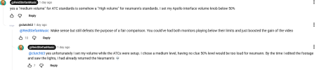

Also, according to the comments below that video, only the ATC were playing at a "medium level", the Neumann were playing significantly louder:
:facepalm:
I would have thought the guy in the video had set the volume individually to approximately the same SPL. What is the sensitivity for the KH310 MkII?
