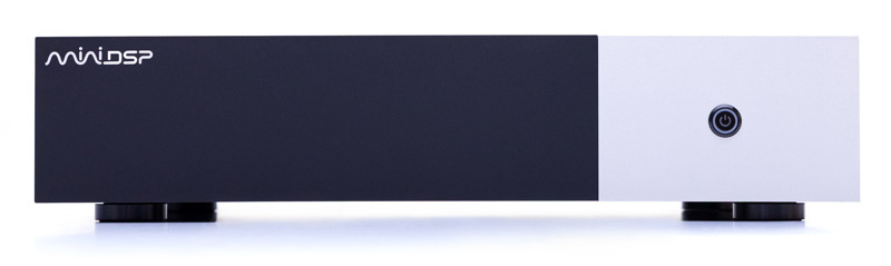

I got an email from MiniDSP today which announced this new eight channel amp. Looks pretty good to me.
If I were setting up my cinema system again I'd probably use one. :)

ICEpower 300A2s are nice modules, the first ones that came close to competing with Hypex.
Sounds like 4x 300A2s with a 1500S power supply, unfortunately this means power output will be limited by the power supply. Also, disappointing that they do not have an easy way of bridging a module without opening the chassis, there is a BTLselect pin that needs to be pulled high to synchronize the channels.
IMO, 8 channel amplifiers have too many drawbacks and the space savings are not worth it over multiple 2-4 channel amplifiers.

Anywhere a picture of the internals of this amp?
