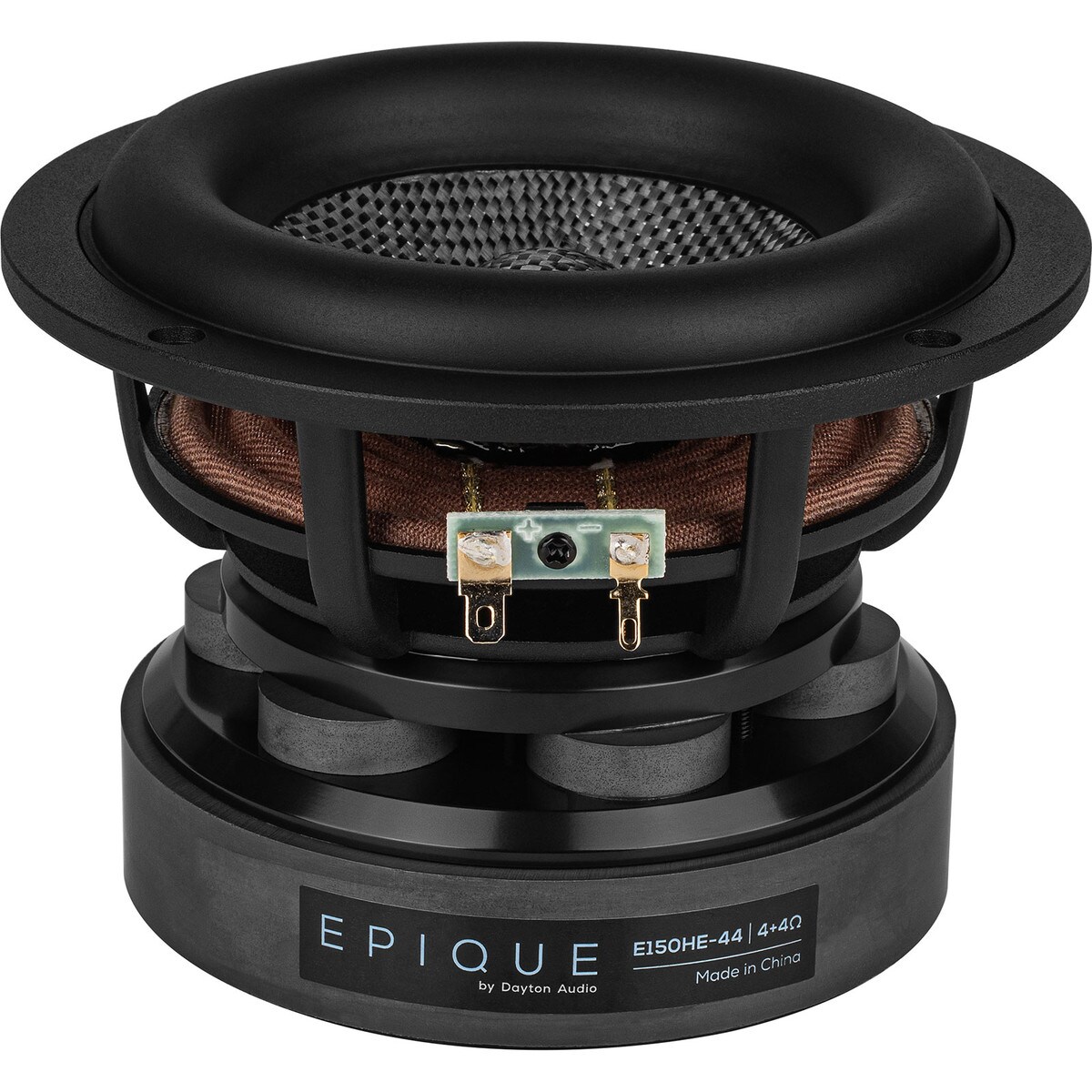

Were the new Epique drivers considered?
Very nice drivers, but not ideal for this design given their physical depth. Definitely a driver that is contention for future designs.
