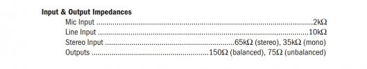

I found this for you, does this show the phones out impedance ?

Will my mixer be able to drive the 250 ohms model or should I try the 32 ohms??
Soundcraft claim 300mW at 150Ω (=6.7Vrms)
We can safely asume that output voltage will stay constant, or at most increase slightly with the higher impedance of the DT 770 Pro 250Ω.
Considering the DT 770 Pro 250Ω sensitivity of 101dB/Vrms, a conservative estimate would be 101+20*log10(6.7)=117.5dB SPL Peak.
For reference, my usual listening volume is less than 10% of what the EFX12 + DT 770 Pro 250Ω is capable of. 117dB SPL Peak will blow your ears off.
Estimating the maximum output level with the DT 770 Pro 32Ω is not possible with the available data.
However, I can all but guarantee that the EFX12 will provide cleaner (=lower distortion) output with high impedance headphones.
Since it has the power to drive the 250Ω DT 770 Pro, if I had to choose one DT 770 Pro version for the EFX12, it would be that one.
That being said, If I already owned the EFX12, DT 770 Pro 80Ω, and MDR-7506, then I'd definitely not buy yet another DT 770 Pro. Its sound quality just does not justify the price.
Instead I'd look into some open-backed headphones (HD560S etc), or a dedicated Headphone Amp (e.g. L30II), so that I would not have to work around the likely poor quality internal Amp of the EFX12.
