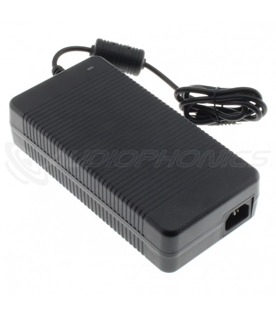

Yes, the 10A ones seem to be "worth" $75+ especially if branded.
I've seen the 5A ones only add $10-15 compared to "no PSU".
For the A7 Mono specifically, I'd maybe spring for adjustability, have 51V at 10A available for dance party mode, leave at 40V 5A normally for longevity. depending on how thirsty the speakers ofc

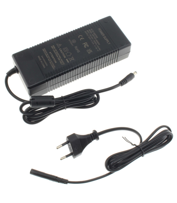

There are some options below 50 € with 36v and 42v.
Although I recognize the second one as the plastic box used by many cheap psu. Handle with care.

The problem I have with this plastic case is that on cheap versions the power jack often has only a vague halt. It's moving when you use it and when you push it a little more you can really losen it. Seen it a couple of times already.
That mustn't be a problem of the case altogether, it can also be the psu and how it is fit inside there. It's the cheap ones + this case combo from what I have seen.
IMO it's best to shop for a known good psu and not get the cheapest from Ali.
