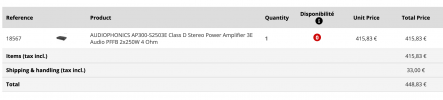

This amp cost 448EU including shipping to the US. Seems more than fair considering what the individual parts cost to DIY.
