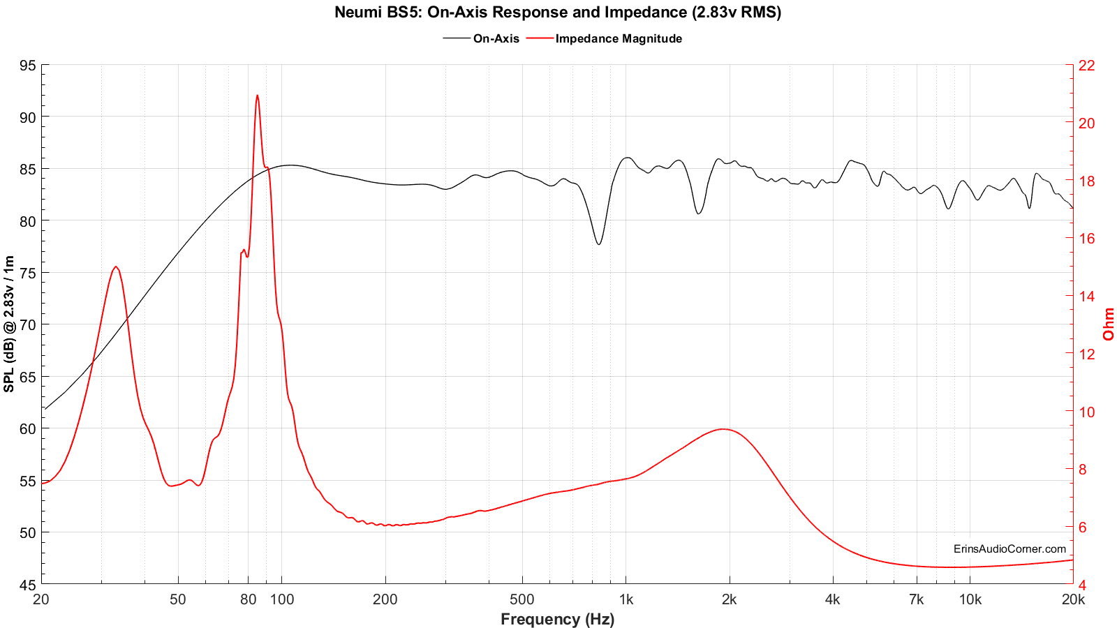

Impedance Phase and Magnitude:
Impedance measurements are provided both at 0.10 volts RMS and 2.83 volts RMS. The low-level voltage version is standard because it ensures the speaker/driver is in linear operating range. The higher voltage is to see what happens when the output voltage is increased to the 2.83vRMS speaker sensitivity test.

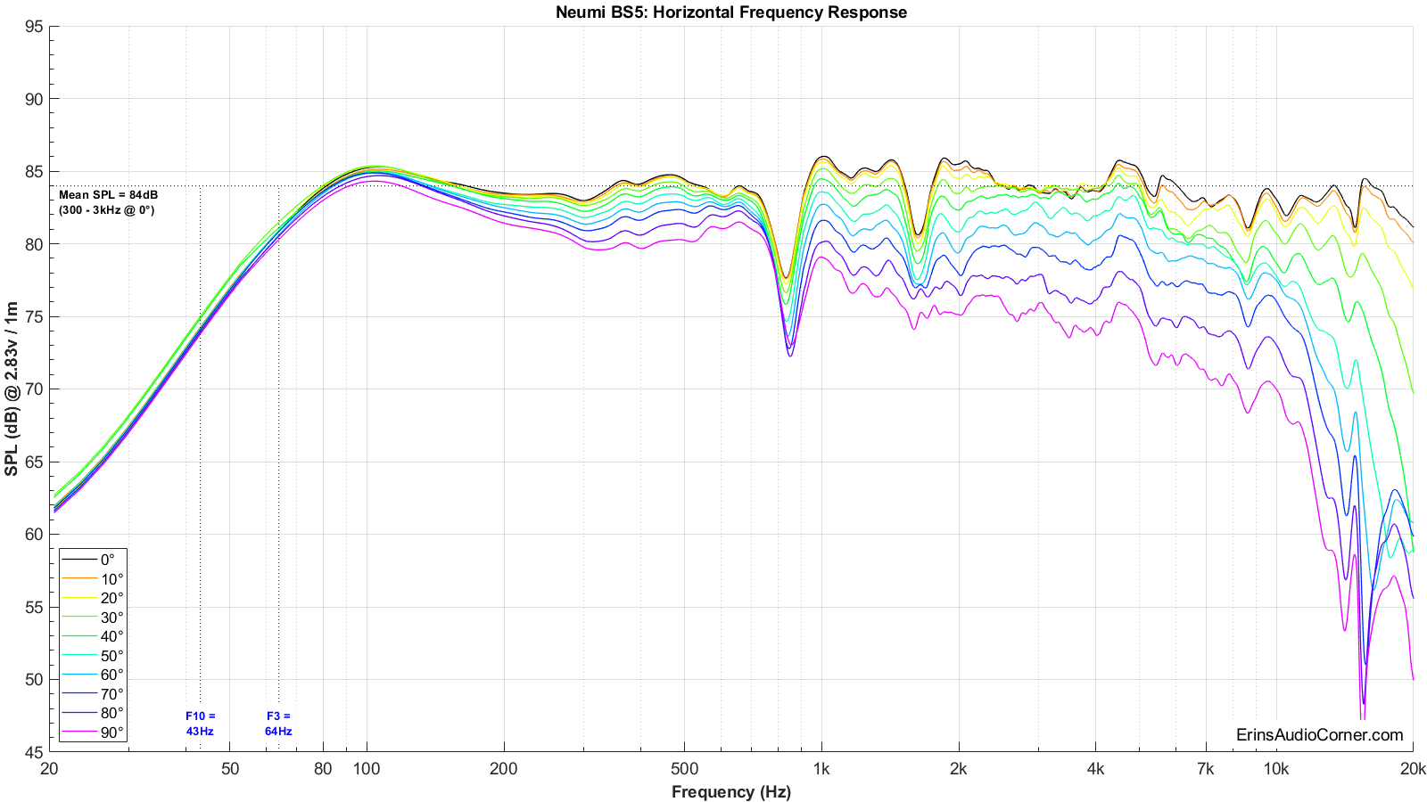

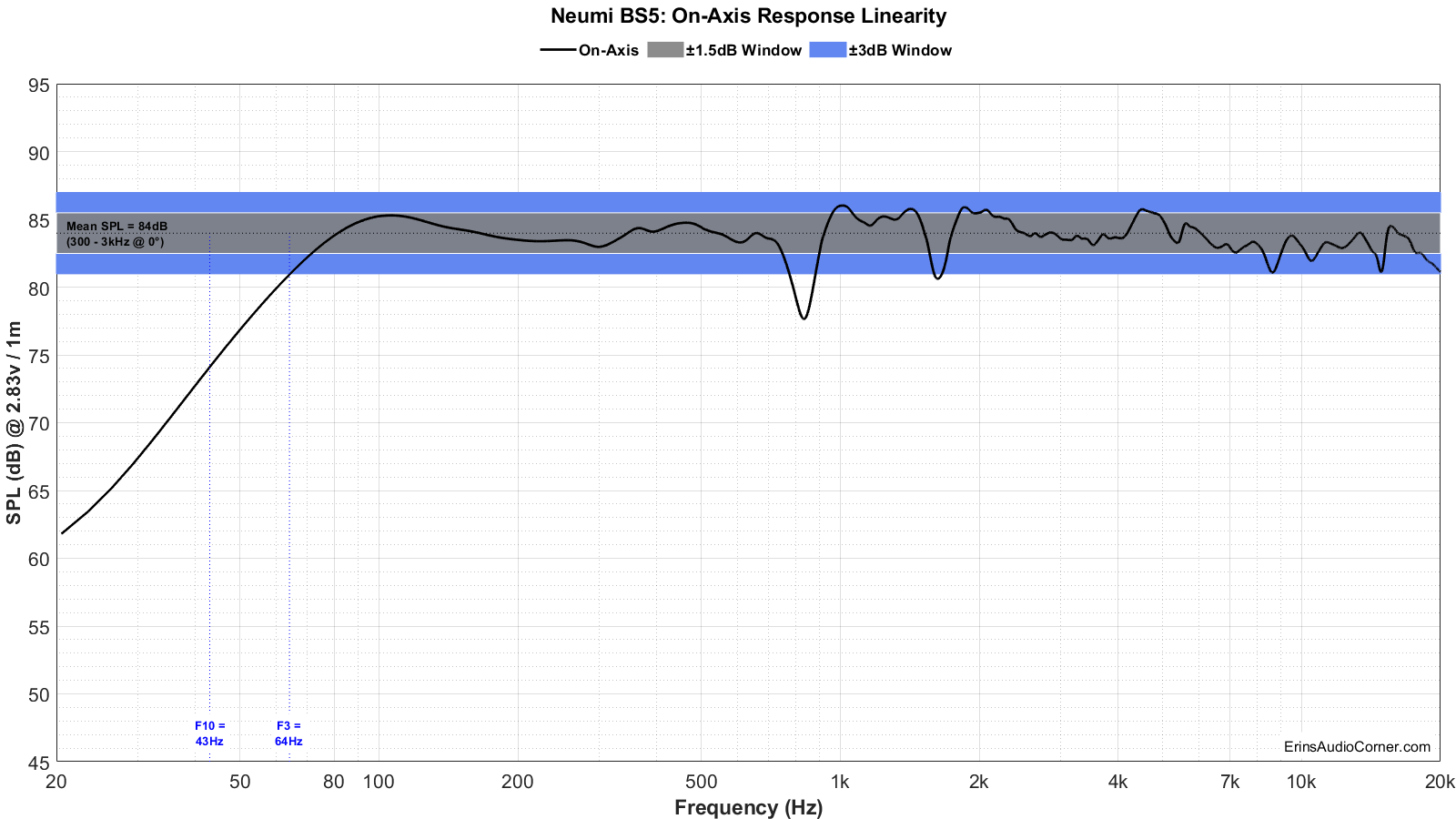

Frequency Response:
The measurement below provides the frequency response at the reference measurement axis - also known as the 0-degree axis or “on axis” plane - in this measurement condition was situated in-between with the woofer and the tweeter per the product manual. While the manual does do a good job of directing the user how to set up the speakers, I emailed Neumi to ask about listening angle and the grille use. I wanted to make sure I used the speakers the way they were designed to be used. Below is our email exchange:
I purchased your BS5 bookshelf speakers and was wondering: Are these designed to be listened to on-axis (with the speaker aimed directly toward the listener) or at some angle off-axis? I assume the former. Are these designed to be listened to with the grilles on or off? I assume off, as most speakers perform worse with the grilles on. Thank you.
Hi Erin, Thank you for your inquiry! The BS5 are designed to be listened to pointed straight forwards. If you like to have a slightly brighter response, you can point the speakers more towards the center position. We also tuned the BS5 without a grill. The grill was made afterwards to minimize its effect on the speaker output. It is fairly transparent but does change the response slightly.
If the speakers are to be aimed facing forward, that would be approximately 30-degrees off-axis in my room. I can toe them in or out if you recommend using a different positioning angle than this.
Hi Erin, Thanks for the additional information. I would start out pointing straight, then try it with 10-15 degree toe-in and see how that sounds to you, more than that, the toe-in would be pretty extreme and is not recommended.
So, per Neumi’s direction I listened to the speakers both on-axis (0°) and off-axis (≤30°) horizontally. I found the best angle to be directly on-axis. Otherwise, the treble was too subdued. When it came time to measure the speaker, I verified that 0° gave the most linear response and conducted the rest of my analysis with the reference axis being at 0° horizontally and between the mid/tweeter vertically.
Also, per Neumi’s direction, the grille was off for these measurements. I do have comparison data of the grille on vs off in my Miscellaneous section below.

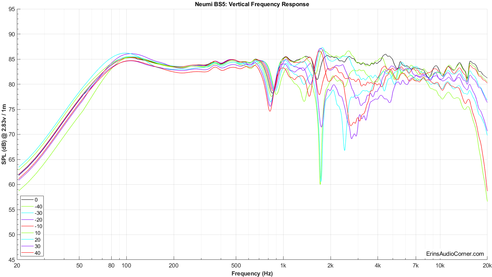

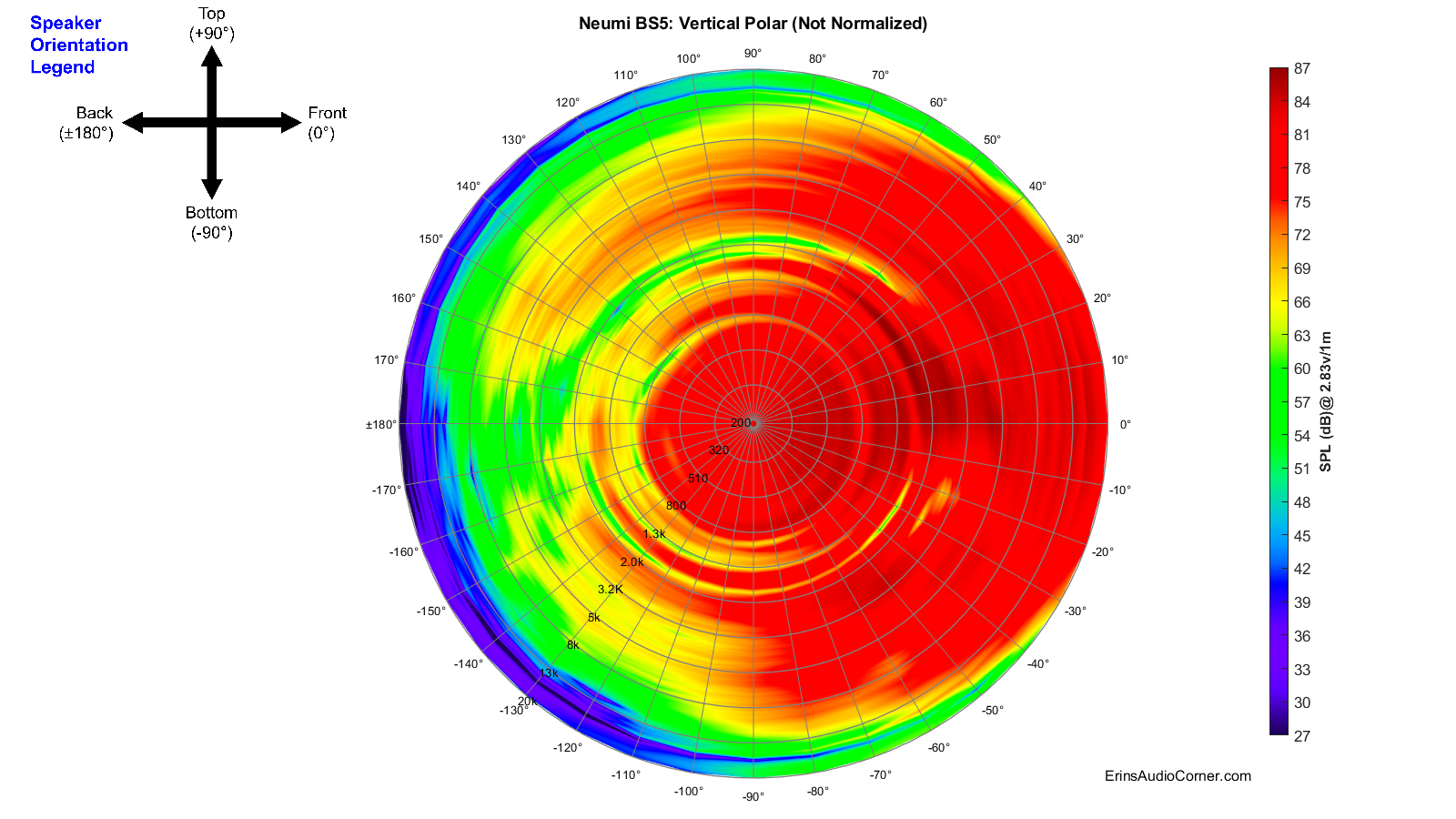

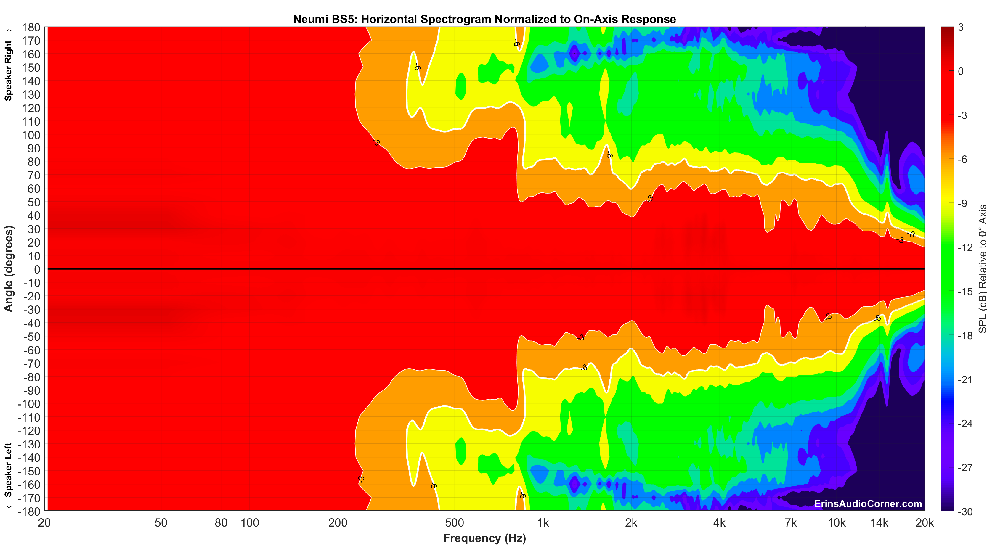

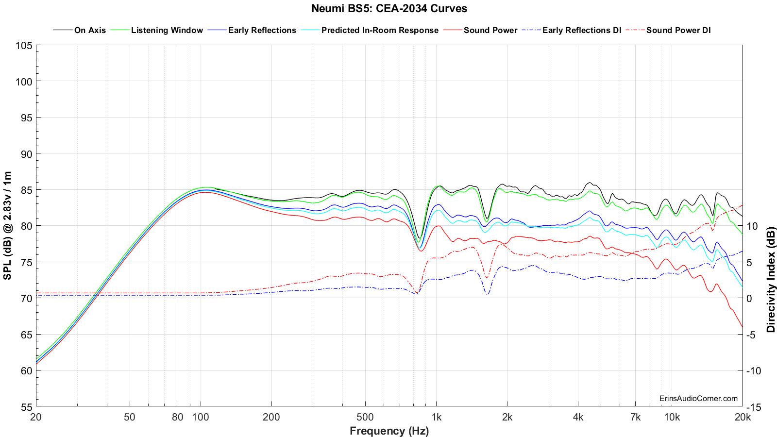

CEA-2034 (aka: Spinorama):
What we can learn from this data is that this speaker has significant directivity problems thanks to the deep nulls at ~800Hz and ~1600Hz. You can see it in the above spectrogram and globe plots as well as in all the measurements in the above graphic. The crossover is stated as 2.1kHz by Neumi and the nearfield data backs this up. Therefore, in this region you can see the directivity mismatch. Looking at 1kHz you see a rising DI until approximately 2.5kHz where the Early Reflections DI dips back down again. This is a sign the transition from mid to tweeter is occurring as the woofer is beginning to beam (radiate more forward than omnidirectional) and the tweeter is taking over, omnidirectional until approximately 6.5kHz (calculated based on dome size of 1 inch). The DI flattens out a bit through here but as the tweeter begins to radiate more directionally the DI increases again above ~7kHz. The tweeter rolls off sharply above 16kHz, causing directivity to increase further. What does this all mean to you? Well, mismatches in what is coming directly at you, on-axis, vs what is reflected around you can cause issues in stage and tonality cues.

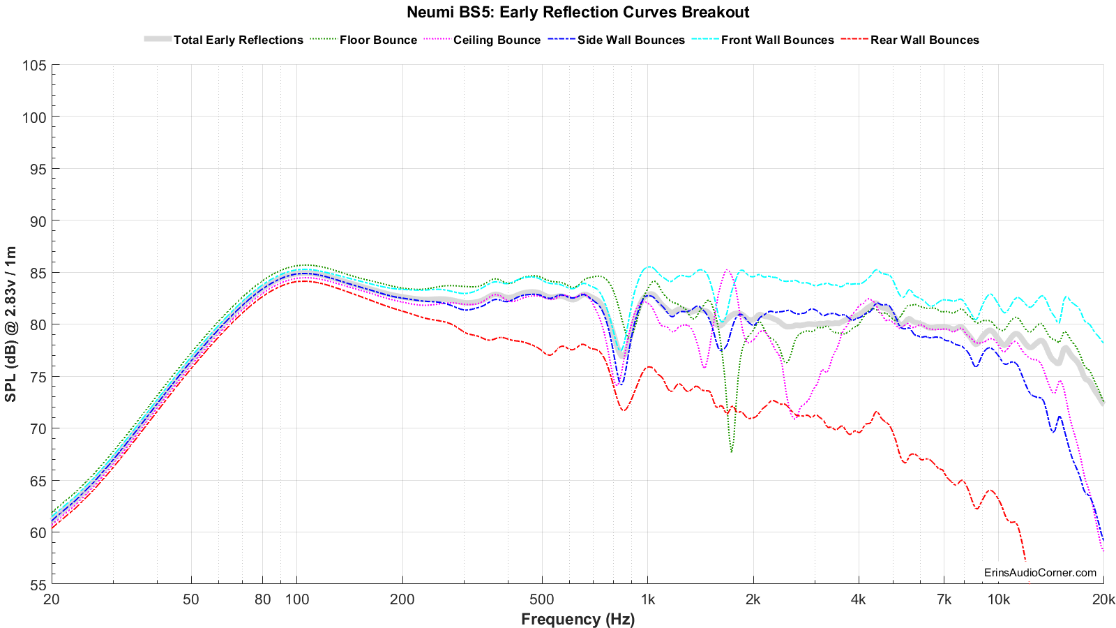

Below is a breakout of the typical room’s Early Reflections contributors (floor bounce, ceiling, rear wall, front wall and side wall reflections). From this you can determine how much absorption you need and where to place it to help remedy strong dips from the reflection(s). Notice the strong dips again at 800Hz and 1600Hz.

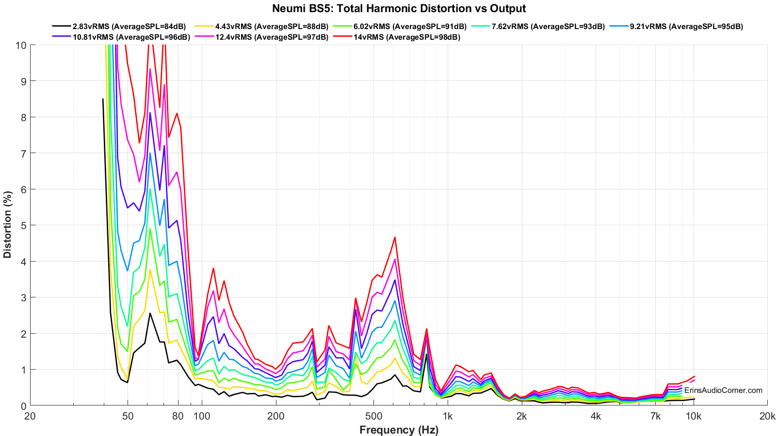

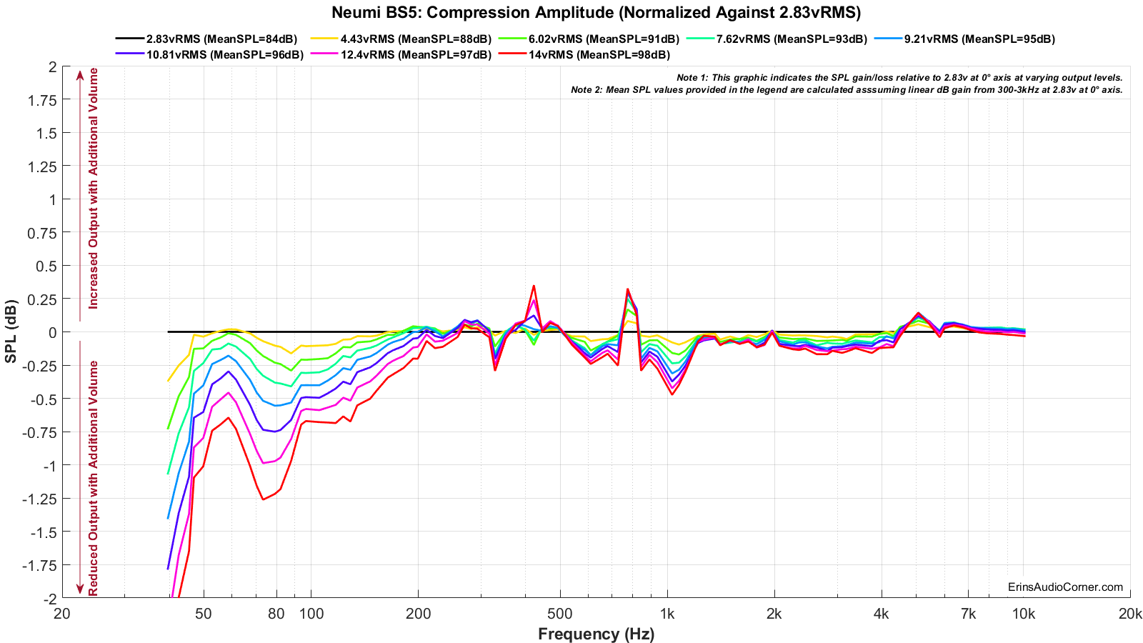

Total Harmonic Distortion (THD) and Compression:
Using the 93dB measurement tells you the measured low-frequency distortion at about 80Hz is near 3% THD and 6% at 40Hz. Will you hear that? Pure distortion is more subjective and depends not just on the listener but also no the program material.
I typically use distortion to tell me where mechanical failures are because the distortion I hear is typically either a rattle, buzz, plop from a woofer extending too far, or something along those lines. The bass is usually the problem. But in this speaker the midrange exhibits distortion at higher output levels and was also audible in my listening (primarily with male vocals).
The compression effects shown in the image below are a visual way of seeing just what happens as the volume is increased. This one is straight-forward. Take the legend’s SPL value and add or subtract the data from the graphic. This tells you if you’re losing or gaining output (yes, you can gain output from compression; as un-intuitive as that seems). Mostly, the compression results in a loss due to temperature increase in the voice coil of the drive unit. Let’s look at a specific example. Take the 90dB at 4 meters target listening volume provided above. Again, you need 93dB’s (7.62vRMS) data. At that volume, the highest amount of compression measured is about 1dB at 40Hz and about 0.25dB at 50Hz, decreasing until about 200Hz. At some points the speaker suffered >2dB compression at 40Hz with 14vRMS. Overall, the compression results tell you what common sense would tell you: don’t try to use this speaker in place of a subwoofer at anything other than lower volumes. Otherwise, at louder listening volumes you lose over 1dB of output. And it is audibly present as a very grainy and “limited” sound; there are no dynamics at this output and that’s exactly what I heard in my listening tests when I pushed the speaker to uncomfortable levels.

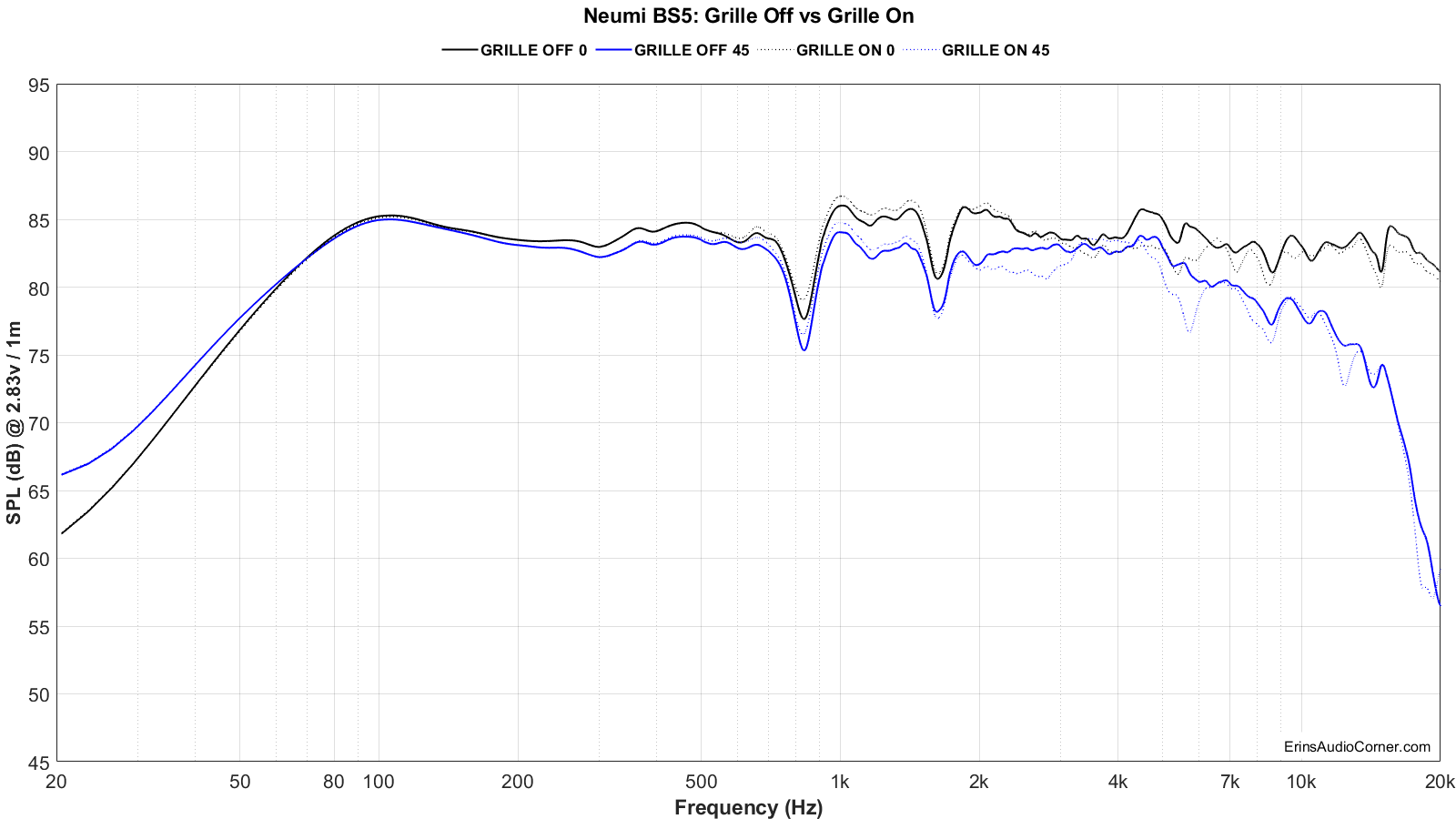

Grille on vs Grille off at 0° and 45°.
The grille on case results in an increase in comb filtering (higher amplitude peaks/dips). Leave the grille off.

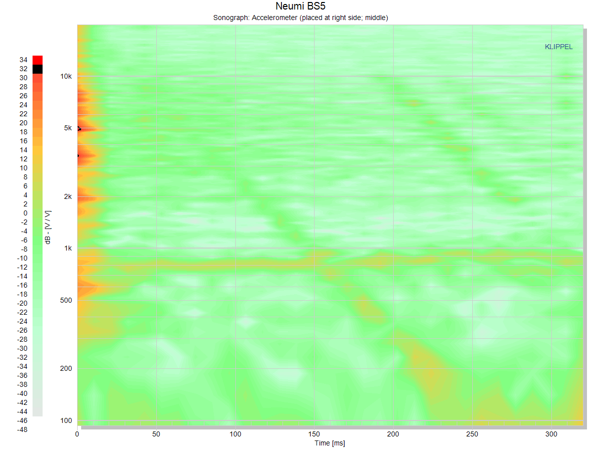

Accelerometer Cabinet Resonance Test.
I used an accelerometer. I attached the accelerometer to the side (top, middle, bottom), back and front of the cabinet and fed a 2.83vRMS signal through the speaker.
I have overlaid all these results against the on-axis response as well. Note, however, the accelerometer is NOT calibrated for level and therefore is only intended to show relative changes. What you look for in this data is large peaks that would indicate a resonance. I’m seeing a lot of mountains and molehills, but I don’t think this data is conclusive enough to do anything other than make a mountain out of a molehill. Others may disagree.
Since the accelerometer is not calibrated for voltage in the above graphic, I chose instead to view the results via a Sonograph, shown below. This shows a long decay for 800Hz - 900Hz. This seems to line up with a resonance of the ports, shown in the next section.

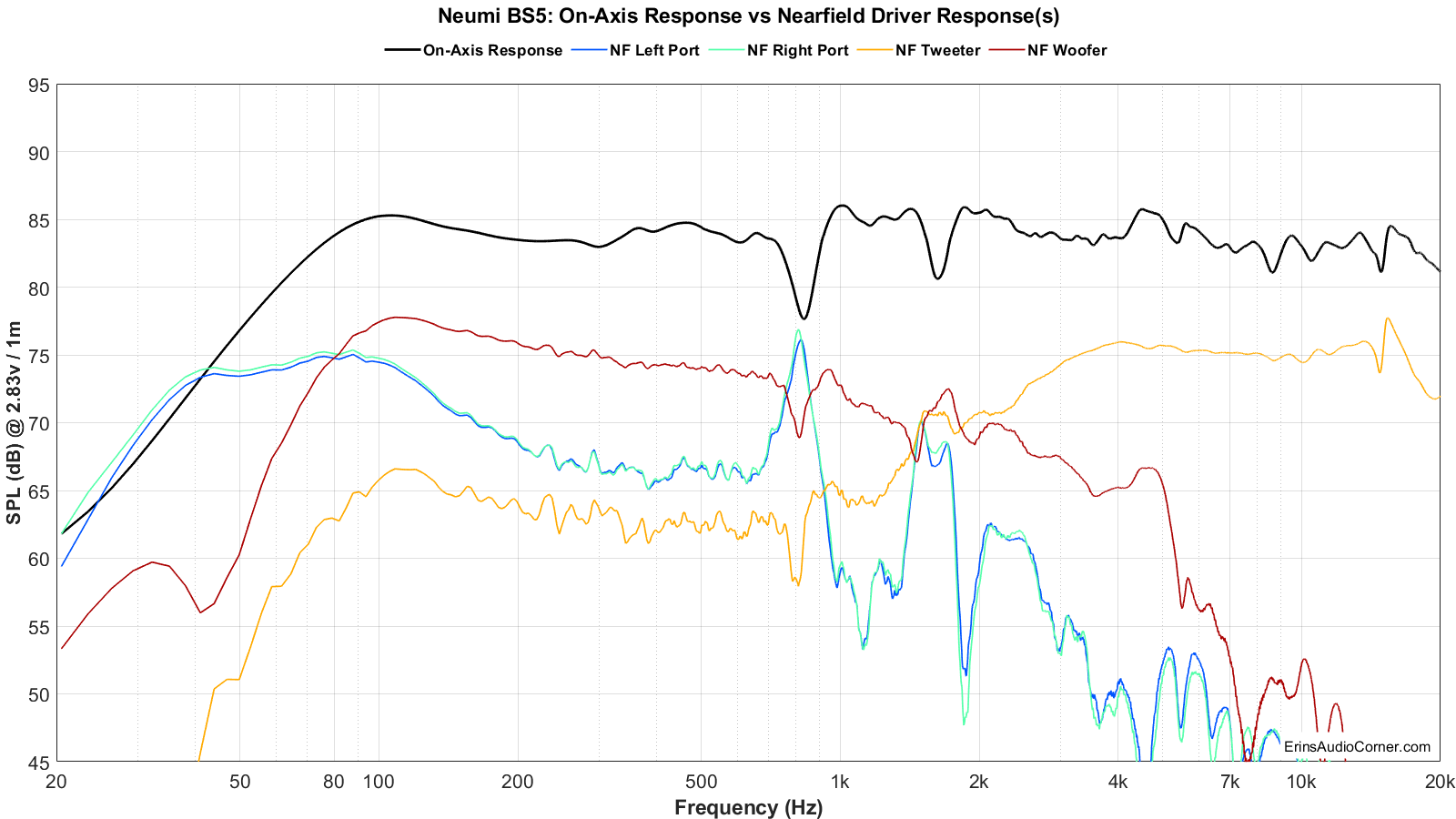

Nearfield measurements.
Mic placed about 0.50 inches from each drive unit and port. While I tried to make these as accurate in SPL as I could, I cannot guarantee the relative levels are absolutely correct so I caution you to use this data as a guide but not representative of actual levels (measuring in the nearfield makes this hard as a couple millimeters’ difference between measurements can alter the SPL level). Got it? Good.
There are a few noteworthy things here:
  • Port resonance is very, very strong and clearly contributes to the on-axis response dips at ~800Hz and ~1600Hz.
  • The area between 300Hz to 700Hz (just before the 800Hz dip) is elevated slightly. This area also lines up with the increased THD levels I discussed earlier. This could be coincidence. But I believe they are related. Maybe the port is having more of an effect in this region than it needs to?
  • Woofer break-up contributes to a few on-axis resonances we see. Particularly, 4.5kHz.
  • There are other things going on here but I don’t have the time to reverse engineer this speaker. Not that I could.

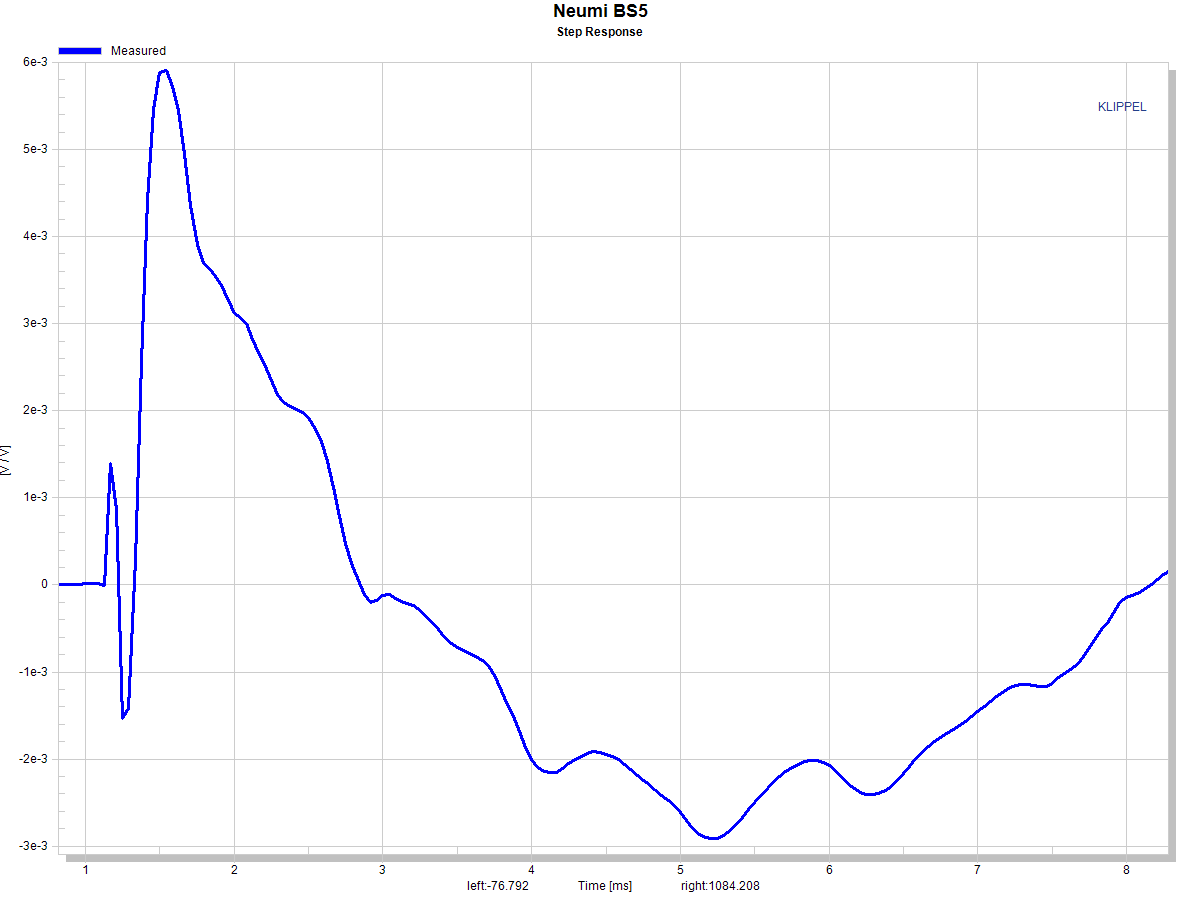

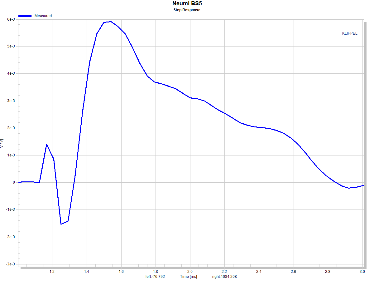

Step-Response.
One not zoomed and one zoomed.

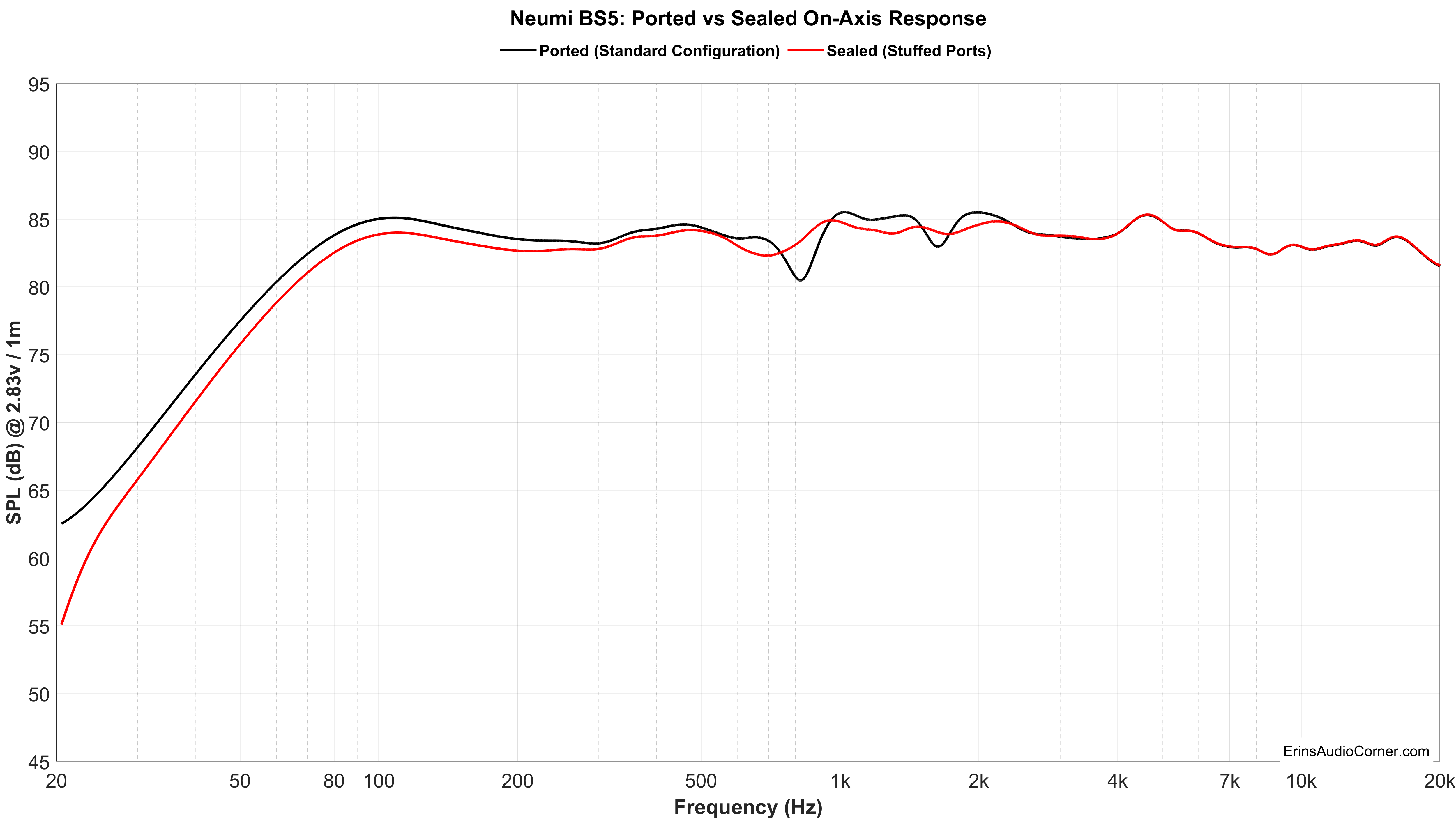

Plugging the port (making the speaker sealed).
To test whether the ports were, indeed, the culprit of the deep nulls I took my socks off and plugged the ports. Don’t worry, I had only been wearing the socks for 3 days. Sure enough, plugging the ports filled in the nulls. But it also decreased the low frequency output by about 2dB below 300Hz.

Frequency Response/Spectrograms/Globes/Spinorama:
  • I measured an average of 84.2dB @ 2.83v/1m.
  • I measured a ±3dB response from 64Hz - 20kHz but only if you ignore the dip in response around 800Hz. Neumi claims a ±3dB window of 50Hz - 20kHz (typical in-room). Buy a subwoofer if you want to listen loud and low.
  • Numerous resonances; most caused by the port. Woofer breakup shows up in a few places as well.
  • Directivity shifts caused by inadequate crossover order and resonances from the ports and woofer.
Distortion/Compression:
  • High distortion at 40Hz but understandable given woofer size.
  • High levels of compression at high output below 100Hz.
  • Elevated midrange distortion (audible at higher volumes).
  • These are both audible effects when listening full-range as I did.

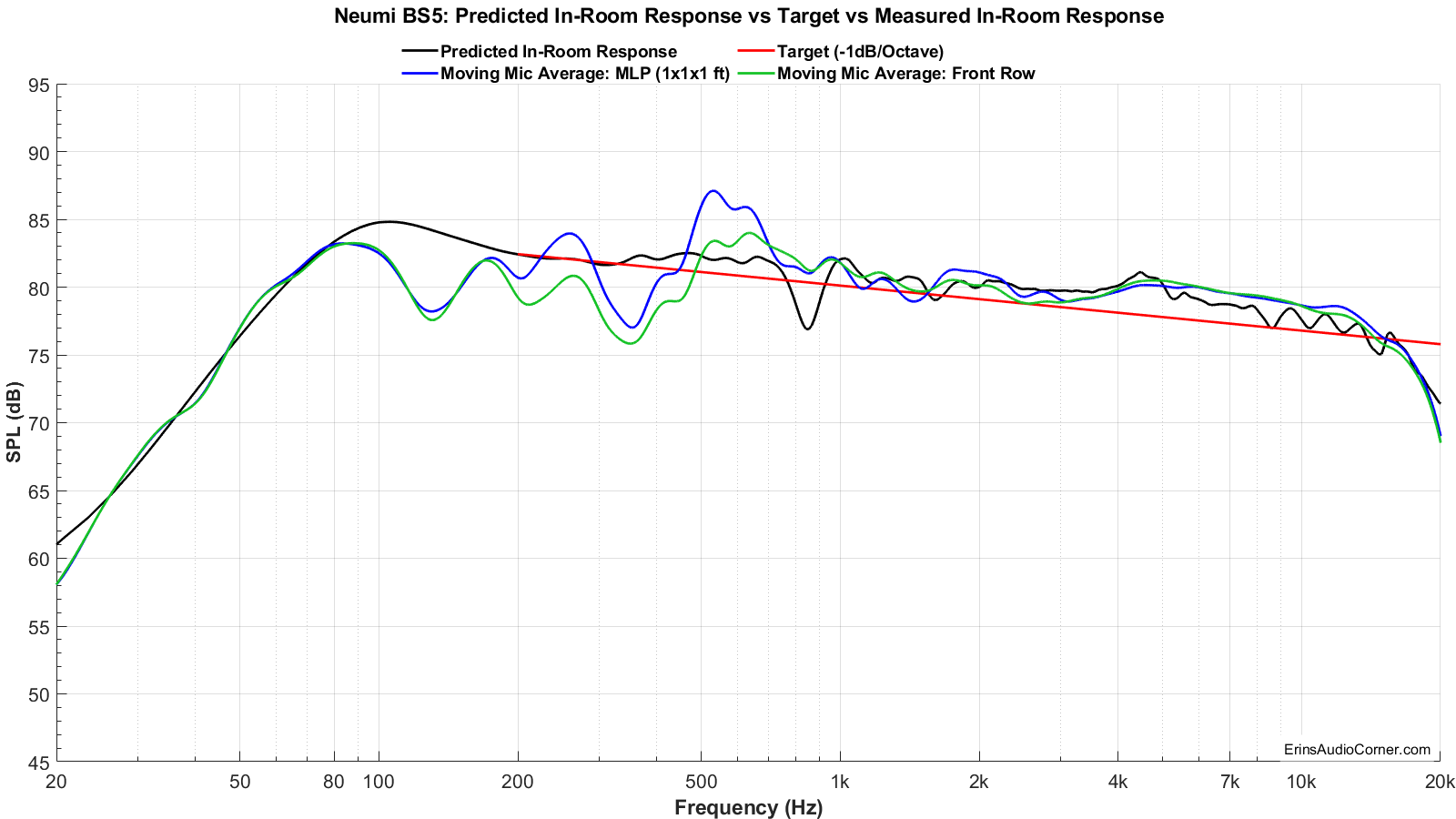

- how would You absorb dips in frequency response?!
- spinorama predicted and real in-room response don't match; Your audio room must be from Mars ;-)
- the speaker is obviously designed according to the limitations of the very (!) small woofer; so distortion figures for about 90dB spl @ 1m are quite sufficient; which look well then; due to intelligent use of the reflex topology one could EQ the bass to flat
Of course nobody should attempt to add a really potent sub to these 40$ / each speakers. They are made as a humble secondary sound re-reproducer, I think. The location of the ports is a bit unlucky, though. Maybe some damping wool would help?
It may be more informative to have HD2 and HD3 in two distinctive graphs. All higher harmonics shall be lower than 0,1% anyway. In case the latter come up a limit is reached.
The response matches well above 1kHz. Below this it doesn't. I blame some of it on the measurement (the seat has a clear impact; I've tested it) and the HT speakers placed behind the bookshelf speakers.
