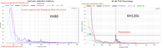

Based on reviews on this forum, I found 2 graphs for thd..I don't know how real they are
The KH80 seems to have higher THD below 300Hz..I’ll look for an opportunity to compare 80 and 120ii side by side..
It get's more obvious at higher levels and even Neumann data shows. And you notice when comparing the 2.

btw - this THD peak is only measured with the Klippel measurement system. I could not reproduce it with my Audio Precision, as far as I remember Production Partner also didn't measure it and it's not in the Neumann data. It's still unclear what's going on here.

There are 3 most important characteristics for studio monitors(In my opinion): 1) THD 2)speed/impulse 3)phase coherence + frequency response

So far I only see an advantages with THD graph the rest can be understood from listening in a specific place.
