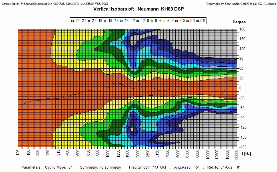

These 2nd round measurements make us ask more and new questions... I've been tinkering about that 20kHz 3D disfference, but I can't get hold of it.
An elliptic waveguide+tweeter should measure pretty well until interference with midrange (or woofer in this case) happens. The KH80 obiously has LR4 symmmetric slopes (correct is LR8!) and measurements represent only the tweeter above say 5khz.
Here is measurement of KH 420 vertical dispersion, tweeter looks identical. Notice symmetric up/down response at 20kHz
