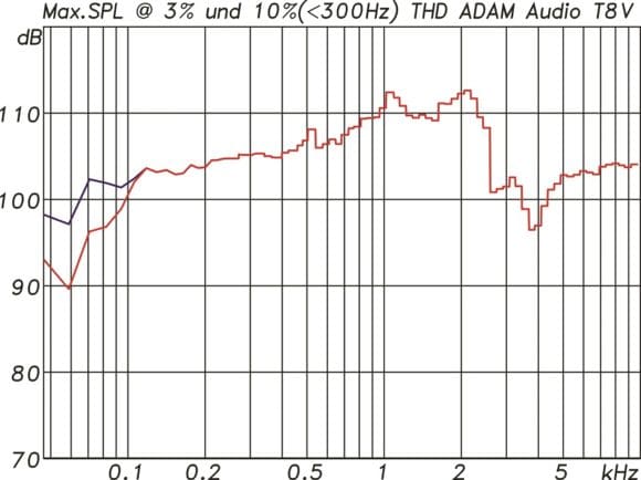

Keep in mind that these guys can go seriously loud once crossed over to subs. Even the KH120 II is not too far from the 8" ADAM T8V (and that's one of the best budget 8"s).
Maximalpegel bezogen auf 1 m Entfernung bei höchstens 3 % Verzerrungen (rote Kurve) und bei höchstens 10 % Verzerrung (<400 Hz) (blaue Kurve)
At a 2.6m distance such a system would likely be more than SPL capable for home theater use above low/midbass frequencies, but I would likely step down to KH 120 IIs or even KH 80s for surrounds. Agreed with the above that the "best" center would probably be another KH 150. However, the big caveat is how you would manage subwoofers. I don't think a pair of KH 750s would get the job done for me (they are also very expensive), so that means you're likely going elsewhere for subs, which eliminates the benefits of Neumann's MA-1 alignment software.
