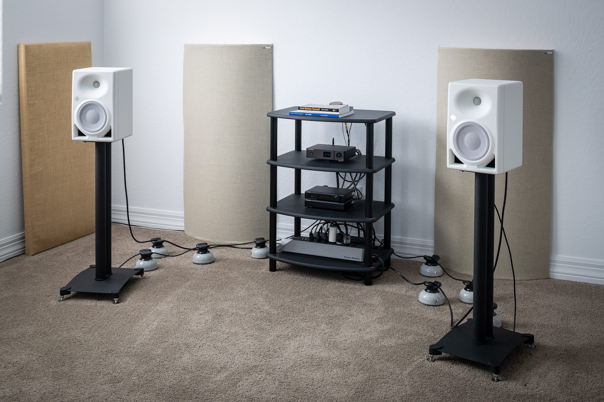

I finally got around to getting my shiny new Neumann KH 150s placed on the stands this past weekend:
The tweeter-to-tweeter distance is 6 ft. Ear to tweeter is 7 ft, 9 in. I recorded some log sweeps from the listening position using REW and Acourate. I was quite surprised (and pleased) to see an initial ICCC value from Acourate of 96.3%.
