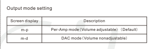

Certainly DACs exist where you can turn the volume function On or Off in the menu, but I have never heard of one where this is format specific.
Volume control is either on regardless of the audio format, or it's off regardless of the format.
And if your DAC has no such Option in the menu, then you can safely assume that volume control simply cannot be turned off.
