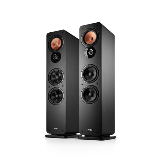

Hi everyone, this is my first post on the ASR forum!
For the past three months, I’ve been working (with the help of AI tools, but unsuccessfully) to put together a hi-fi system that suits my needs, and I’d really appreciate your input.
My setup goals:
Room size: ~20 m²
Listening levels: moderate to high
Music genres: Jazz, Jazz Fusion, Blues, Blues Rock, and Metal
Source: streaming services like Spotify, Deezer, and Qobuz
Sound preferences: I’m looking for a sound that’s immersive, dynamic, and clear, with good headroom and low distortion
Budget: I don’t have a hard limit, but I prefer to buy gradually if that means better quality. For an integrated amplifier, though, I’d like to stay under €1,000 for example.
What I’ve already purchased:
1. Wiim Ultra – music streamer
2. Teufel Ultima 40 Mk4 – passive speakers
+ ( Acer Nitro v16 and Hisense 55e8q TV)
What I’m looking for now:
An integrated amplifier with at least 100W per channel and a dedicated headphone amplifier (for late-night listening)
Headphones (considering HiFiMan Ananda or Sennheiser HD 660S2)
Possibly a separate DAC/headphone amp like the Topping DX5 II
Initial thoughts: I was considering the Yamaha A-S701, but I noticed its SINAD is significantly lower than the Wiim Ultra's, which makes me question whether it’s a good match.
Questions for the forum:
Should I go with the A-S701, or is there a better-integrated amp ( class AB or class D) in this price range that pairs well with the Wiim Ultra and my speakers?
Would it be better to separate the speaker amp and headphone amp entirely?
Any suggestions for headphones that pair well with Jazz and Metal?
Note: I tend to buy once and hold onto gear for a long time, so I’m aiming for a setup that will stay satisfying for years.
Thanks in advance for your help!

Here's what I'd do:
WiiM->RCA->3E Audio/Fosi/Topping Amp
WiiM->USB->DAC+Headphone Amp combo (e.g. DX1, DX5II, Element IV)
WiiM → USB → Topping DX5 II is a solid chain—I'll take your advice and run it exactly like that.
WiiM->RCA-> Topping amp ( for the RCA route: which Topping amp is the reliable 100W pick that simply works without issues?)
Your speakers require significant power to perform their best, those are no small bookshelf speakers.
Many ways you can go about getting there, I would look at using the wiim ultra as the preamp itself or using a headphone amp that doubles as a preamp instead of going for a traditional receiver then you can get a more powerful power amp.
Consider the Dayton Audio A400 - https://www.parts-express.com/Dayto...lZXgcUKEzGxkEzI1Pp1G8sZiueZrgDogaApaEEALw_wcB
you could then use the pass through to a headphone amplifier like a schiit vali or fosi gr70 and utilize the volume control on the A400
Or you could go with a schitt Midgaurd or saga2 so you can jump the signal up to balanced connections for a range of power amps. Something like the Avantone CLA-200.
but I think your speakers will greatly do better with an actual power amp than a a typical integrated or receiver in these price points. .....your speakers are basically needing 200wpc+ 4ohm this is no small amount and double what the yamaha's will give you.
While the product has its strengths, a common complaint among users is its noticeable lack of power.
That all depends on a specific systems requirements, speaker sensitivity etc... you mentioned "at least 100W", your speakers are 4 - 8ohm and Amir measured 134W@4R and 73W@8R on the Vibelink.
Continuous power handling (IEC - Long Term) 120 W
Sensitivity (2.83 V / 1 m) 87 dB
Frequency range 39 - 20000 Hz
Peak power capacity (IEC - Short Term) 200 W
Maximum sound pressure level 108 dB/1m
Impedance 4 - 8 Ohm
The 3e Stereo has slightly less power than the Vibelink, but the monoblocks much more.
They're both power amps though, you mentioned integrated... there are many more to recommend if you are only after power amps.
Not really. They are 87 dB efficient, which isn’t particularly low, not very high. Nevertheless I would say 100+ watts into 8R would be a good minimum, and already enough to reach the theoretical maximum of 108 dB/1m. Bigger speakers don’t generally need more power. In fact general the inverse is true: bigger speaker means better efficiency, so less power demand.

As always, "4 - 8 Ohm" in notorious German fashion means it's a nominal 4 Ohm speaker. So you can forget 8 Ohm power figures of amplifiers, focus on 4 and current delivery. Gladly, the speaker is a rather benevolent load:
Still profits from a bit of power due to only average sensitivity, but doesn't need heaps either. Rough estimation in an average European living room: 2x100W and you're set, including house parties.

Yes, that's exactly how it works. I have 87dB speakers here and have used them with different amps over the years. A 2x70W "my first Sony" type, and a chunky 2x200W hybrid amp with oversized everything and huge power transformer. Up to a certain point it sounds exactly the same, and that point is very loud.
That’s the easiest choice. Super high SINAD is irrelevant at home, as it’s just for bench testing (and bragging rights) but the Yamaha will be quiet enough for normal usage. You benefit from a conventional design, versatile inputs and controls, classic styling, and the support of a huge Japanese brand.

The amount of power needed for a given SPL is dictated by the efficiency of the speaker and the power you put in. The higher the efficiency, the less power is needed for the same SPL. How much current is needed for this will, for sure, depend on the impedance, but as long as the amp delivers the numbers, you're fine. The issue arises only when the numbers on paper turn out to be incorrect. There really is no mystery here.
The 108 dB Maximum SPL you will already reach at 100W or less, depending on room placement. A bit of overhead is fine, but I can tell you right now that these speakers will not last long when playing with real music content at the peak rating of 200W. Then again, a lower power amp driven into clipping is probably just as much of an issue.

Teufel Ultima 40 aren't crap, but far from gold either. Personally I'd call them the absolute minimum for "hifi". The price (400/pair) reflects that, and for that they're actually quite good considering the concept and size.
Spending the other way around, 1000 for speakers and 400 for an amp, would be VASTLY better. I know it's a hassle returning speakers and starting to look again, but @ŽELJKO you might want to consider that. There's a lot of great speakers for 1000 and less that, honestly, will eat the Ultima 40 for breakfast in every aspect. And a lot of amps fora 400 that will do the job perfectly fine.
The total amount here (1500-2000) can easily get you a VERY nice stereo that's balanced, clear, and fucking loud all at the same time. If you take your time and invest wisely. Wiim Ultra is already a very nice source and convenient too, so that's already covered.
Thanks for the thoughtful replies, everyone – the thread has actually helped me boil the question down to two concrete paths.
1.
Keep the Teufel Ultima 40 Mk4 and buy a €400-€500, 150-200 W/4 Ω, SINAD-clean class-D power stage (Topping PA5 II, 3E Audio 250-2, Fosi V3 Mono, etc.).
– Cheap, measures well, plenty of head-room for these speakers, no headphone section needed because the DX5 II will already cover that.
2.
Send the Teufels back, raise the speaker budget to €900-€1 000 and mate them with a €350-€400 integrated (Yamaha A-S701 or the new WiiM Amp Ultra).
– Gives me a demonstrably better transducer, but I lose the raw power the class-D blocks offer and, with the Yamaha, I drop 15-20 dB of SINAD.
If I stay with the Teufels I know I’ll enjoy them – I’ve already heard them in a mate’s place and they’re a big step up from the Panasonic micro-system I lived with for so many years.
The “buy better speakers first” argument is absolutely valid, yet swapping boxes again means another month of couriers, repacking, and living with TV sound while I hunt for the next candidate. At 51 I’d rather start listening now and upgrade later when I’ve learnt what I actually crave in a speaker.
So, unless someone can point to an integrated under €1 k that simultaneously:
- does 150-200 W/4 Ω with good current delivery
- keeps SINAD ≥100 dB
- remains a valid choice for the time I choose to upgrade the speakers and buy the better ones
…I’ll take the first road: keep the Teufels, add a clean class-D power amp, and run the DX5 II for headphones.
If that chain still leaves me wanting in a year or two, the amp will happily drive whatever fancier speakers I audition next.
