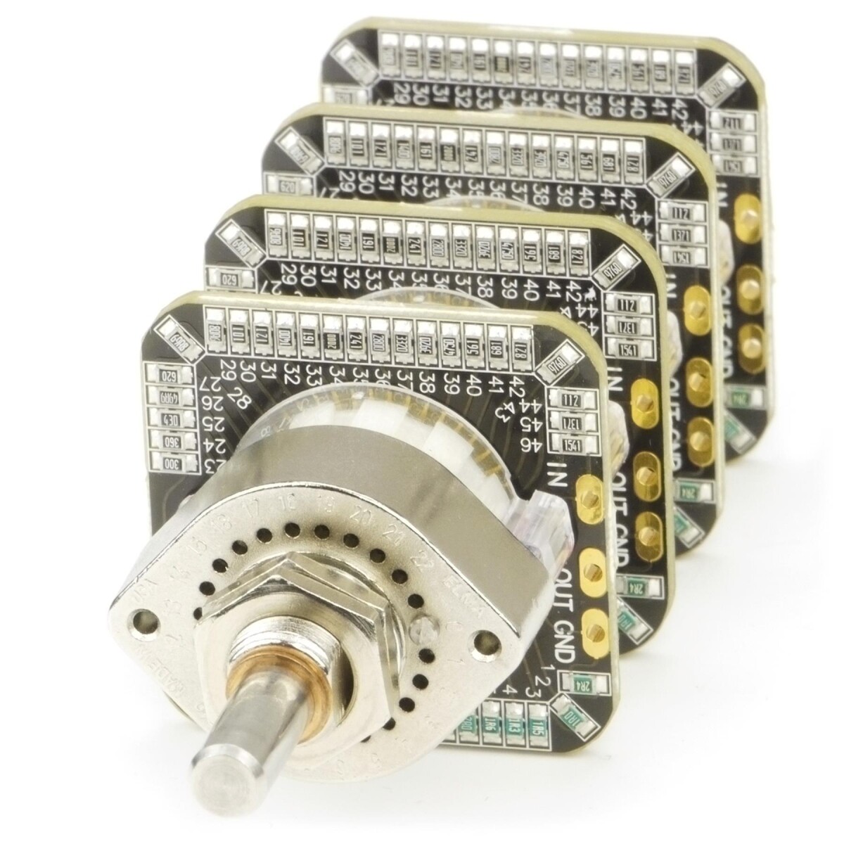

So I ended up just getting a 2-channel passive stepped attenuator - a Chinese DACT imitation. The Heritage Audio Baby Ram looked promising, but then I read a lot of comments about quality control/reliability problems in some pro audio forums. So I just settled on this stereo unit, using it to set a max level for my mains while matching my sub level by ear using the sub’s gain/level knob. I‘ll continue using the Flex volume control to fine tune my listening level because changing the sub gain is a pain in the ass - the knob is in the back and I have to use a mirror to see it, and I have to be really attentive so I don’t accidentally turn the knob in the opposite direction than my intention.
One problem I encountered with this compromise setup is that if I use brickwalled K-pop to set my max volume, it’s too quiet for classical symphonic music. But if I use classical to set my max volume, the next time my Flex decides on its own to squeal at 0dB, the volume will still be loud enough to jeopardize my mental health. So with my volume limiter setup, I won’t be able to crank my classical music quite as much as I would like.
So I’ll just use this for now until one day someone comes out with a 2.1 or 4-channel attenuator that’s reliable and not DIY.

It’s an overkill but does the job
If you have DIY skills this or similar will be much cheaper

That SPL unit would do the job, but I would feel silly spending way more on my volume controller than on my Flex. Unfortunately, I’m not a DIYer. I was just going to buy 2 of these cheap stereo attenuators and match both knob positions, but I thought I might as well just use the gain knob on my sub instead.
If you buy two stereo switched attenuator units instead of continuous pots your level match will be very near each other.
Yes, that was my original plan, but I hate clutter and redundancy, so I decided to just use my sub gain knob and new attenuator to set the max level one time and continue using my Flex to adjust the volume for daily listening, since it has a convenient remote. I thought that would be preferable to getting out of my chair and turning 2 separate knobs every time I wanted to adjust the volume.
