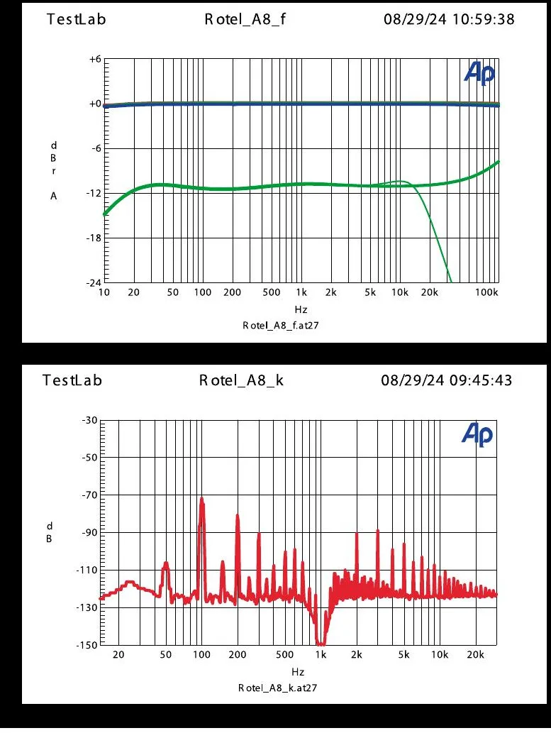

The Rotel A8 seems to have some problems with the power supply. 40 Watt at 4 Ohms (specs) is also a bit shy.
So maybe the NAD 316 BEE is a bit of a preferable choice with a better SINAD. The NAD with its 60 Watts can play 1.5 dB louder.
