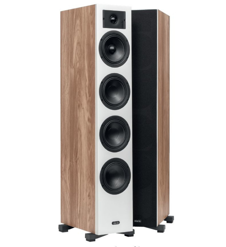

In my setup I’m using:
WiiM Ultra → (USB) Topping DX7 Pro → (XLR) Fosi V3 Mono → Indiana Line Diva 6 speakers
No matter what I play, even if with quite high volume, the woofers barely move. The bass is clearly audible and extends, but visually the drivers hardly move. What could be the reason?
My video with Diva 6 (same song) -
I even set in Wiim EQ 40-60Hz +7dB, and cone is still not moving

First of all, the Diva6 has more bass drivers, which significantly reduces movement at the same volume.
Is the demonstration room larger, taller, and less damped than your room?
Could it be that the system in the demonstration was operated at a much higher power level, perhaps even 4 or 8 times more power than you'd use at home?
Add to that the difference in sensitivity; the Diva5 requires about 50% more power than your Diva6 for the same volume.
That is 4x 150 mm extra woofer area. More area means less movement is necessary to achieve the same sound pressure.

Excellent woofers don't usually move a lot visually to do a great job with most musical content.
Typically, reproducing a sound in the 30Hz range or lower is required to see increased visual speaker movement but even then it doesn't necessarily indicate a superior speaker design.
If they sound great to you, that's enough.
The "more woofers" thing is, within the design constraints of a modern, narrow speaker, an established method of reducing distortion and getting more volume capability both. The power (both electric and resulting acoustic) is divided between them, so each one will work within optimal voice coil and cone movement ranges - not moving a lot - in a larger volume range than a single one could. These are general tendencies dictated by physics, of course drivers will vary a lot in detail and there's other factors influencing this, like size and especially cone mass in relation to voice coil size/strength and other things.
If your cones aren't moving much but you still get loud and deep bass, that's the sign of a good design. The less movement, the less distortion, because the drivers are still far from their maximum capabilities.
It's also good for that "fast and precise bass" impression: a barely moving driver takes very little time to stop again after the signal ends (like short, loud bass note), naturally, compared to a much more moving one. The latter will get into "bloated and muddy" territory more quickly, simply because more movement takes longer to stop. This is also the reason why big PA woofers typically have a rather "hard" suspension: to compensate for their high cone mass due to size. You still want fast response so your bass doesn't "blur and smear". With slim home speakers with small drivers you don't need that, the moving mass is much lower.
Finally, such videos have to be viewed with caution. A strongly moving driver is good for "badarse demonstration" for advertising. "Look at how impressive our drivers are! They can pump like crazy!" - while in reality it could just as well be too much subbass content the drivers can't even do properly, but are struggling hard to. Not a good sign. A driver approaching its limits will inevitably compress and distort.
Also, our hearing is logarithmic while woofer movement is linear. If you are playing 10 dB lower than the example video, then the sound will be just loud instead of very loud, but the reduction in woofer movement is dramatic. Many audio shows have been measured to have rooms playing somewhat above 90 dB.

First of all, you need ten times the power to double the volume.
The listening room at the dealer/show is likely significantly larger. How far back is the room, or is it open? You can already see from the side that it goes around a corner.
At a demonstration, the sound is significantly louder than at home, even if it doesn't seem that way.
At home, you're usually around 50-60 dB, rarely 65 dB. Anything above that quickly leads to problems with the neighbors.
At a dealer's, you're easily talking about 75-85 dB.
And that means we're not just talking about 4 or 8 times the power, but 10 times or more.
Even the single 16-inch woofer in my Elac DBR62s doesn't move like that in a heavily damped room, even when it gets uncomfortably loud.
The difference between the Diva5 and 6 will still be at least 3 dB, which requires roughly twice the power.
Let's summarize:
- The Diva6 has significantly more cone area
- Presumably a much better and deeper tuning and resonance frequency
- At least 3dB better efficiency
Just a rough calculation, I get a maximum of 1/3 of the excursion for the Diva6 at the same volume, or even less.
There's an additional problem with the Diva5. Due to its shallower tuning/higher resonance frequency and lower efficiency, the woofers also have more excursion in the lower frequency range, since the bass drivers have practically no resistance at low frequencies.
This is probably the biggest factor in the movement seen in the video with the Diva5.

I have these too, and the cones aren't moving much because
1) there's two sharing the load, plus the same size mid driver actually playing quite low with a shallow highpass, and
2) the whole speaker and bassreflex path isn't tuned all too low. The ports are actually tuned to reduce load around driver resonance frequency, rather than extra subbass output at all costs. A reasonable decision that works very well and makes the speaker do serious volume at low distortion where it counts, the "fat" 40-50Hz range, because exactly there is where the ports keep drivers in their comfortable stroke range up to ludicrous volume, relative to speaker and driver sizes. Also where most of the energy is in powerful music. Coincidence? I think not. Almost as if they know what they're doing. Heh.
Their higher end models use the same principle, and they're famous for super low distortion north of 110dB. It works!
You have the following woofers per speaker: 3 x 150 mm.
The diva 5 has 1 woofer: 1 x 150 mm
Let's elaborate on concrete example already given.
4x cone area mm²=+6 dB/W or 4xW.
As already pointed out more the woffer stays above it's Fs better as it will stay in its Xmas linear limit (not touching non linear excursion limit) and more to time domain. Same things apply and too big stiff ones (sub's). Good port design is direct to driver Fs (as part counter to it +6 dB same thing goes for good stands design) and cut digitaly under it but you won't find such in HI-FI but mostly PA and DIY and more for max SPL then linearity or distortion. Now when you cut above woffer Fs port will also lose most of it's output and you plug them or not you will get to somewhat in between closed/ported enclosure order slope (18 dB) to where you cut (even if you use higher order low self filter to do it).
