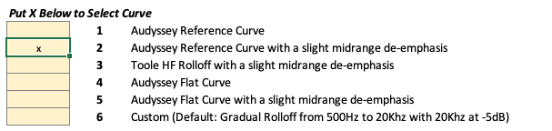

One poster on Audioholics.com posted his new UI that looks like a graphical version of Ratbuddyssey (though not related). It looks like it is preliminary, but it has potential, a welcomed alternative to the $200 MultEQ X.
And, if I remember right, Simple Home Cinema has a version too, that is based on Excel so the interface would be similar to Rat's but much easier to use, I would think:
For $11, if I were still using Denon or Marantz AV devices, would have given it a try, though I like the free Ratbuddyssey just fine.
