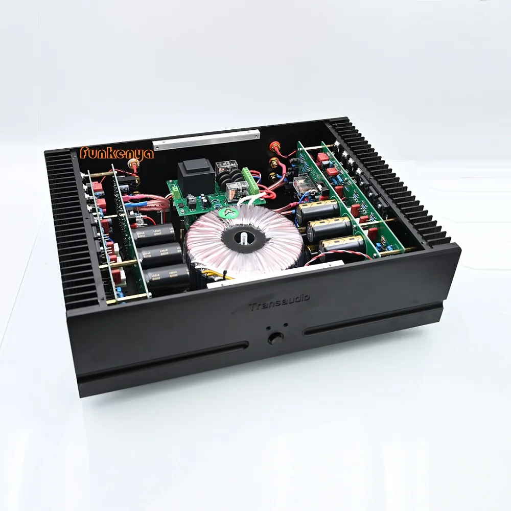

Just for fun :) , I've just ordered THIS DartZeel knock-off from AliExpress. Delivery is expect, (i.e. hoped for), in the next few days Price including shipping was Cdn$800; I expect to pay some taxes, brokerage, and maybe duties.
The vendor asserts ...
"The main amplifier circuit is derived from the Dartzeel-NHB-108, a famous machine with a price of around $50,000. The circuit matches the original 1:1. The selected components also correspond to the original at the key points in the sound and therefore no compromises have to be made in terms of sound compared to the original."
We shall see. I'll get back about this unit.
