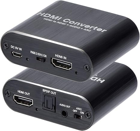

HDMI audio extractor
As for USB-->AES/EBU, that's just your typical sound card.
I don't recall seeing one that does 5.1 HDMI into 3x SPDIF however. It can exist, in theory.
If you use a pro-audio soundcard or USB interface, you can route the channels into 3 SPDIF however way you like.
