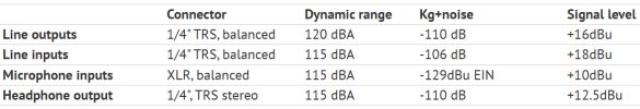

The spec appears to have changed at some point. The version of the manual that I saved a while ago shows different specs:
This is interesting. The manual has changed since this was first reviewed, but well after the M4 v2 was released. Is there a v3 of the M4 which the manual was changed for?
According to the wayback machine, the updated manual appears to have been uploaded on 23 June 2024:
Wayback Machine
You can download the previous version with the original specs as of 16 March 2024 here:
Wayback Machine
