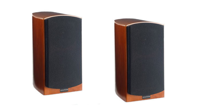

Peachtree Audio 'D4' bookshelf loudspeaker in genuine cherry wood veneer:
Peachtree Audio is reselling used samples 'that may have minor cosmetic blemishes' for $249/pair.
Blech.
I have a grudge against Cherrywood.
I survived in the 90s in which Cherrywood was everywhere and on everything.
All I can think of is the 90s when I see Cherrywood.
Blech.
Time to let it go..... :)
I can’t.
When we moved into our house in the mid 90s the first room renovated was the kitchen . The interior decorator convinced us to go with cherry-wood looking wood (beach wood I think or something). Over the years we renovated different rooms. And our taste has changed. And now I absolutely abhor the wood cabinets in our kitchen.
