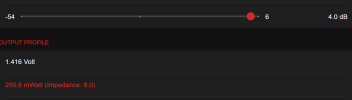

Will a Qudelix 5k adequately power these?
Extrapolating from RAA measurements at 16ohm, I'd ballpark you'd get around 105dB peak SPL using the balanced output before it starts to clip. Probably OK if you're not a loud listener or need lots of headroom for EQ.
The Qudelix 5k chrome extension/app gives you a ballpark estimate of the volume with a specific EQ profile, impedance, and sensitivity, so even though I don't have the headphone, I can at least share what the 5k thinks. You probably won't even need the extra 6db from the high setting on the amp.
