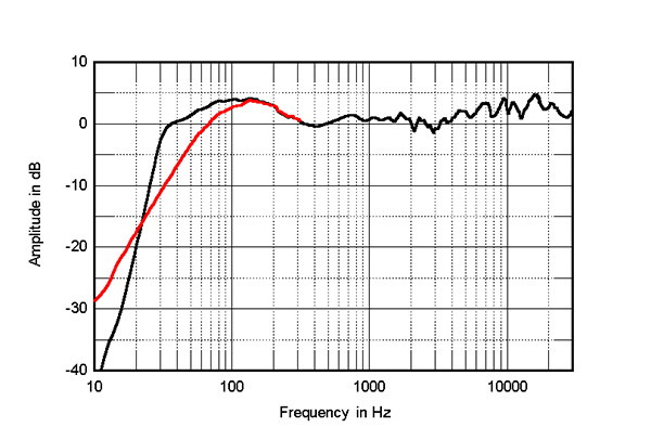

Fig 5 doesn't look too good imo.
Actually, it is very good - boost at the low frequencies is just an artefact of near-field measurements. It is ruler flat from 70 Hz to 4 kHz. Above that is a tad bright, but it can be cured with no toe-in.
