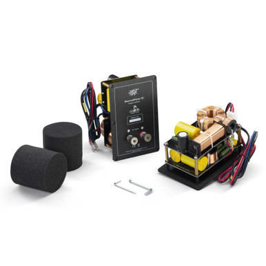

I got motivated to install the MoFi SourcePoint10 MasterEdition kit because I enjoy ripping into my gizmos.
Especially, if there can actually be a benefit or an improvement to be gained from the mod.

No doubt there is a measurement benefit here and is partly why more components are in the new crossover. Many speakers have a comparable impedance peak to the original crossover. Most amplifiers will handle just fine and so is a limited benefit.

The added Zobel (at tweeter) will probably benefit lots of high impedance, older amps and some new load depended ones, that's a no brainer.
The question is about the rest of the network, I see more than the needed resistor+cap a Zobel needs.

I noticed that in the original crossover, on the lower part, there is a 15ohm resistor and a 20uf capacitor, while on the new one there is a 10ohm resistor and a 30uf capacitor. The cutoff point is the same: 530Hz. maybe they increased the woofer volume by about 2db?
The SP10 ModKit arrives with 2 port-plugs, and no mention of them that I've discovered.
[There are 2 (rear) ports in each speaker.]
I've heard that port-plugs supposed extend the bass a bit, along with needing a bit more power...
