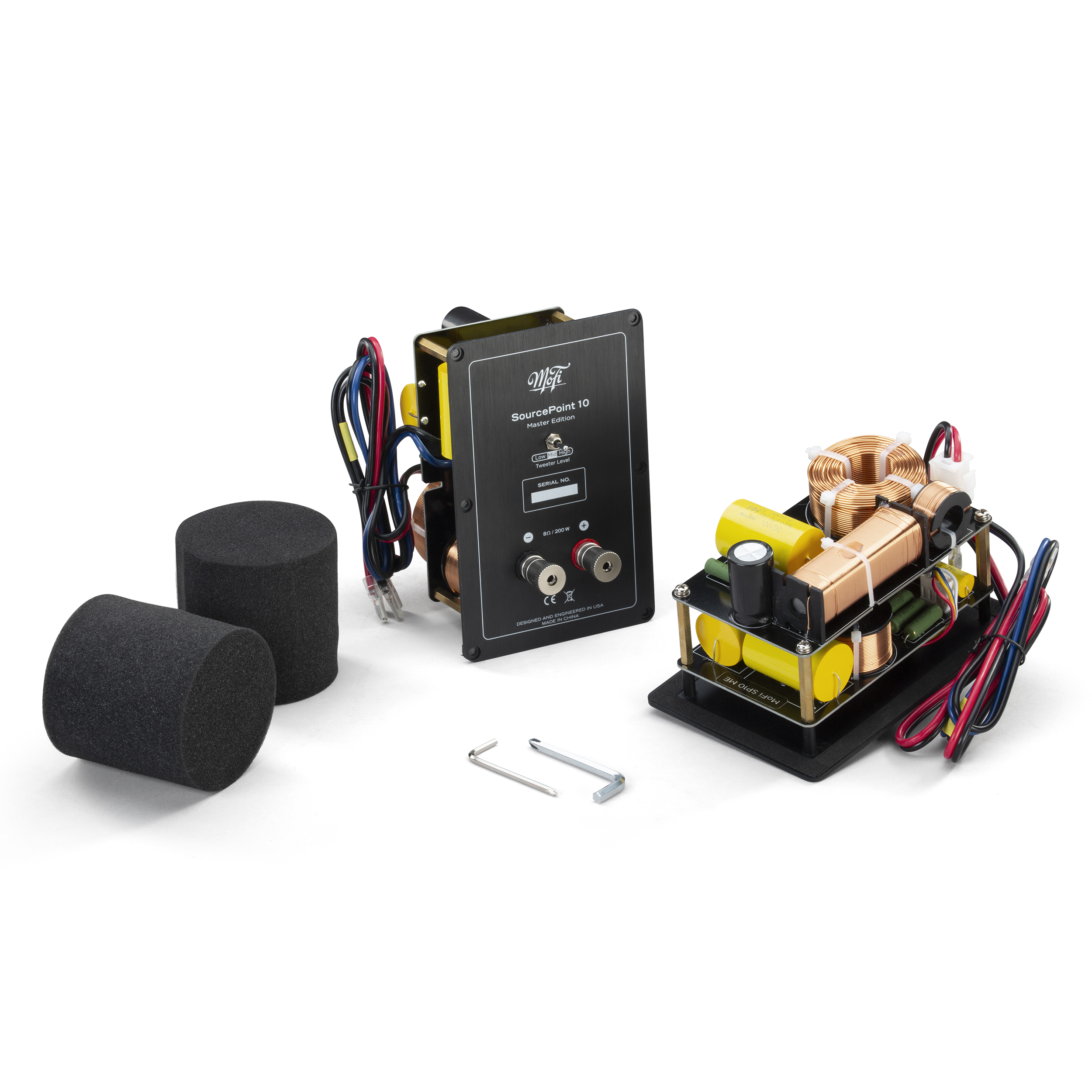

What I am also seeing, in the above photo, are port plugs.:oops:

Looking at the website of the pictures of the new xover, the layout is very poorly done. Look at the orientation of the inductors

Erin thinks the upgrade is worth it, mainly because he thought the original had a tweeter that was a bit too hot. With the new treble/tweeter switch you can change that. The impedance curve has also been changed. The bass range/FR is the same.
View attachment 463831View attachment 463832
The impedance is flattened by a correction circuit so a tube amp could be engaged without too much trouble. There are some extra parts to pay.
Treble arrangement is usually done by exchange of one resistor.

From Erin’s measurements, the new crossover does at least have some added impedance comp. It also appears the bass has been tuned slightly differently. Perhaps to allow better range for the bungs. Based on this, this upgrade would not excite me as an owner. All of the tweeter options (and more) could be done with eq.
