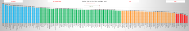

As is, performance lands right at the median of all amps tested:

But it's not bad. It ended up in the fair category. Amir:As is, performance lands right at the median of all amps tested:
