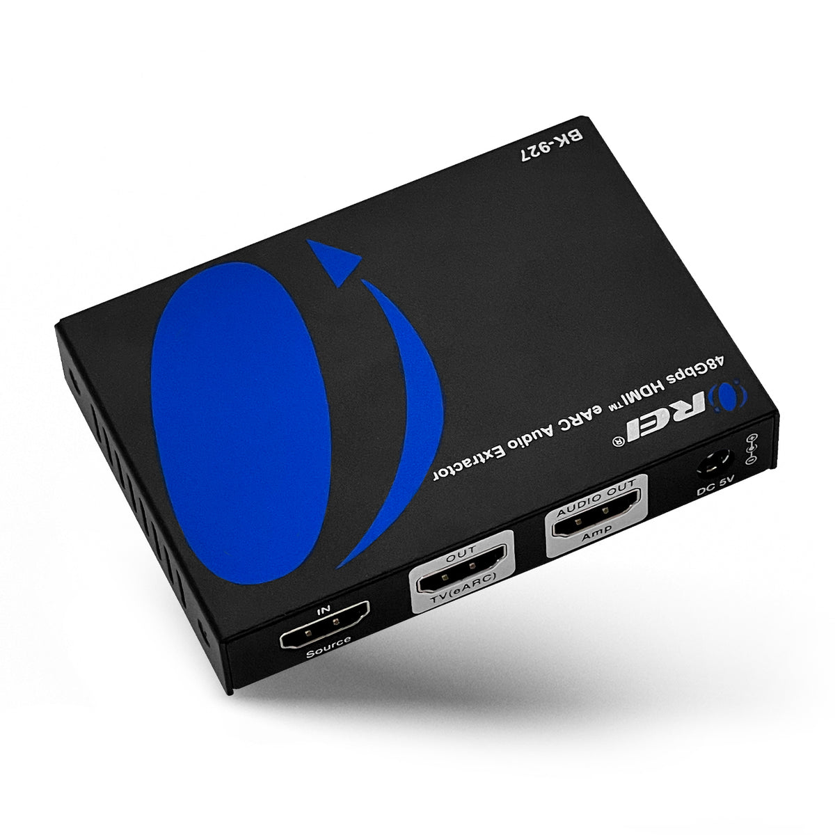

Or this extractor seems even simpler and more up-to-date with modern codecs for 80 usd.
Replace AV receiver with the Flex HTx.
This thing does no decoding at all, only pass through. You still need your source device to deliver LPCM.
