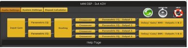

you can connect an amplifier to output 1 and 2 and the second to 3 and 4. This is just an example using miniDSP but there are other DSPs that you can use just as well.
but is there a range of frequencies between an amp treble control (15 kHz) and an EQ dsp?
I don't understand the question.
With DSP, you can choose the exact frequency, e.g. 16 731.4Hz
There are no limits.
