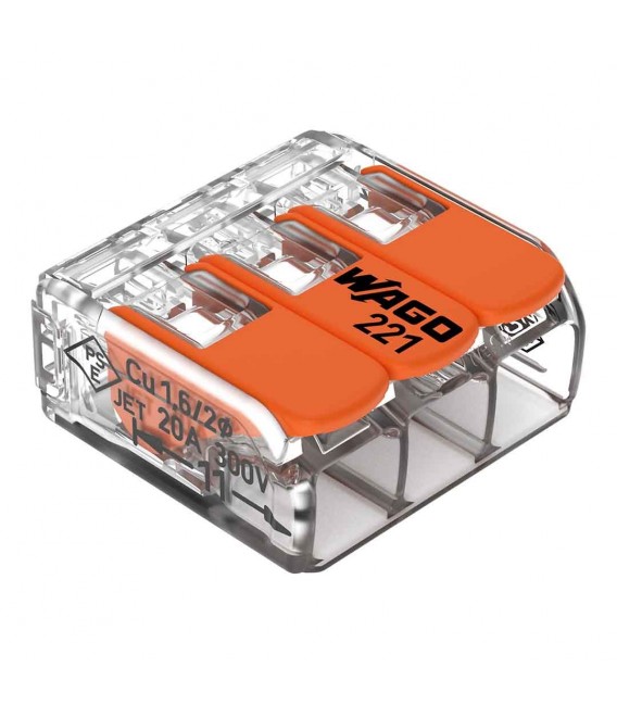

2 power supplies from one IEC, is it best just to solder 2 cables to the IEC tab (twist together to make 1) - 2 cables into a spade connector doesn't seem cool.
Any other solution that I'm missing?

@brunes any of the ways you have listed above will work great.
PE makes larger gold plated spade and fastons that you could get 2 cables into one, as well.

I get the idea, I don't get the logistics of it :) I have 2 fat cables that I can't join at the IEC end with a FastOn connection or the SMPS/JST end.
So somehow I need to join 1 IEC tab to 2 cables.
The wago look good, will go with those! Thanks.
